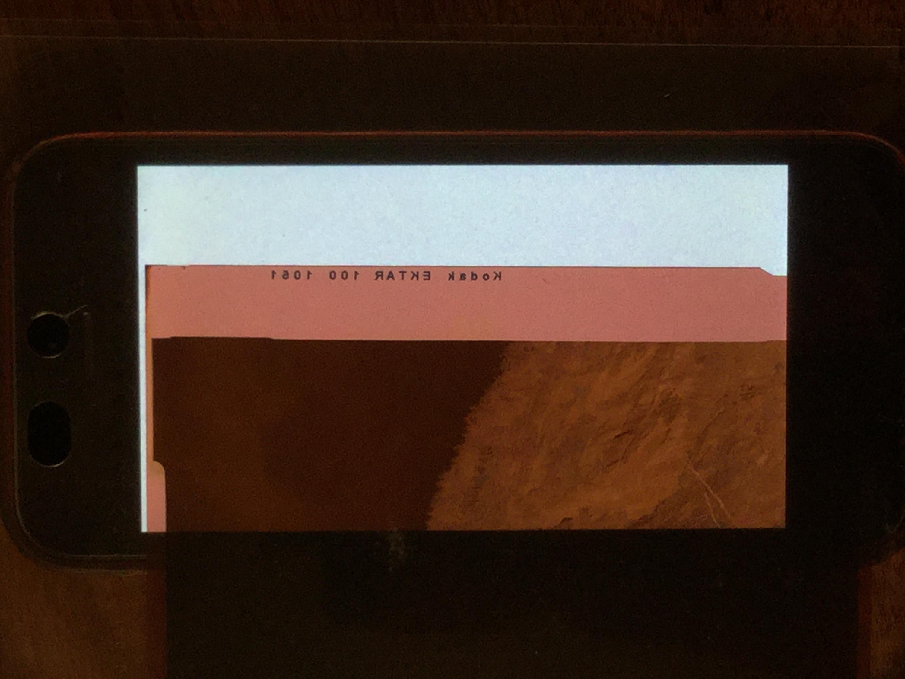

My large format adventures continue, I'm starting to get respectable results, by my own measure at least. I've noticed that most of my negatives are missing part of the image. Somehow I've avoided this on two or three shots, but for the most part I'm seeing a 6x7 ratio on a 4x5 surface. I've considered cropping for 6x7, just because I like the look and I get all of my detail, but I'd rather fix the issue. Any ideas? Am I just not loading the film properly, or is it the way I insert the film into the camera?

Is the missing portion 'suddenly' cut off, i.e. there's a marked point where the image stops? Or is it fuzzy, like something is out of focus?

It is suddenly cut off. It seems like the flap on the film holder is covering a portion of the negative, but as I understand it, the only way to get the negative secure is aligned with the bottom groove of the holder.

What happened is that the sheet of film was not pushed all the way into the holder before the flap was shut and the slide slid in. Tell-tale sign is no rebate on one end and way too much on the other.

All seriousness aside, the negatives were not properly inserted into the holds, so they slipped out. I had the problem with some of the two sheet film holders, but moving to Grafmatic 45s eliminated that problem.

Thank you, I think that about sums it up. Despite having learned this from several YouTube tutorials, there is room for error, I guess I have to push the sheets up higher, appreciate the sincere response. It seemed like a groove at the bottom held them in place but I guess that is just the crease where the flap folds over.

The missing portion is the size of the flap, so it must be covering that much of the negative. These are standard size, not being crushed.

attachment.php

Because I had the same problem a few years ago. I thought the film was secure if the flap covered it, but the film must be pushed all the way into the opposite groove.

I've got that upper groove located, will try on the next batch. I appreciate the advice!

All the film holders I have used the darkslide will not slide in fully easily but can be pushed in with moderate force if the film is not loaded properly.
I had the film fall out into the camera once as the film was in the darkslide track not the base track. The darkslide was difficult to operate, thought I had a dirty track.
Still don't know how I did it but just make sure I don't do it again.

Now that you have a couple of scrap sheets of film, take them and your holders and practice loading with the lights on, so you can see what happens and how to avoid it. Then practice with your eyes closed till loading and unloading becomes second nature.
Then you can tackle those unintentional double exposures :smile:
FWIW, when I load, I push the sheet all the way in the holder with moderate force to make sure it seats at the opposite end. I then lift up on each corner gently to double-check that the film is under the guides. I feel for the code notch at the same time to make sure it is oriented correctly as well.
