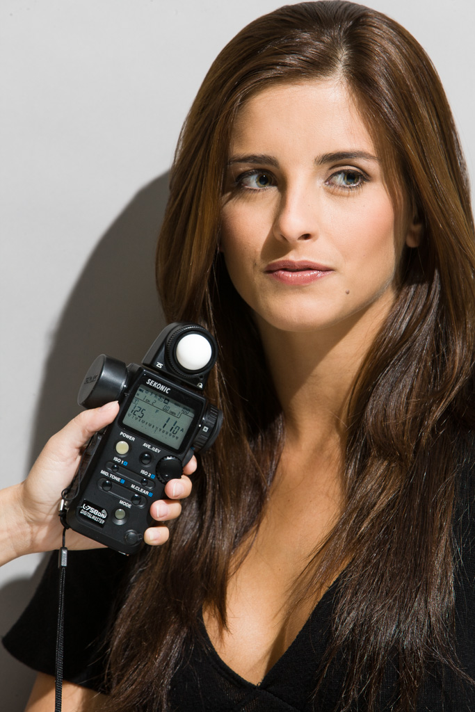

Does this mean that incident readings can't be taken under sun? Are there any books that deal with information like this to recommend.
An incident light reading can be taken in any lighting situation.
It is very simple to do. You place the incident meter where the subject is and you point the white dome towards the camera. Then take the reading. This will give you the correct exposure for your subject.
This is how it would look from the camera's point of view.
You could have a look here for some more explanations
