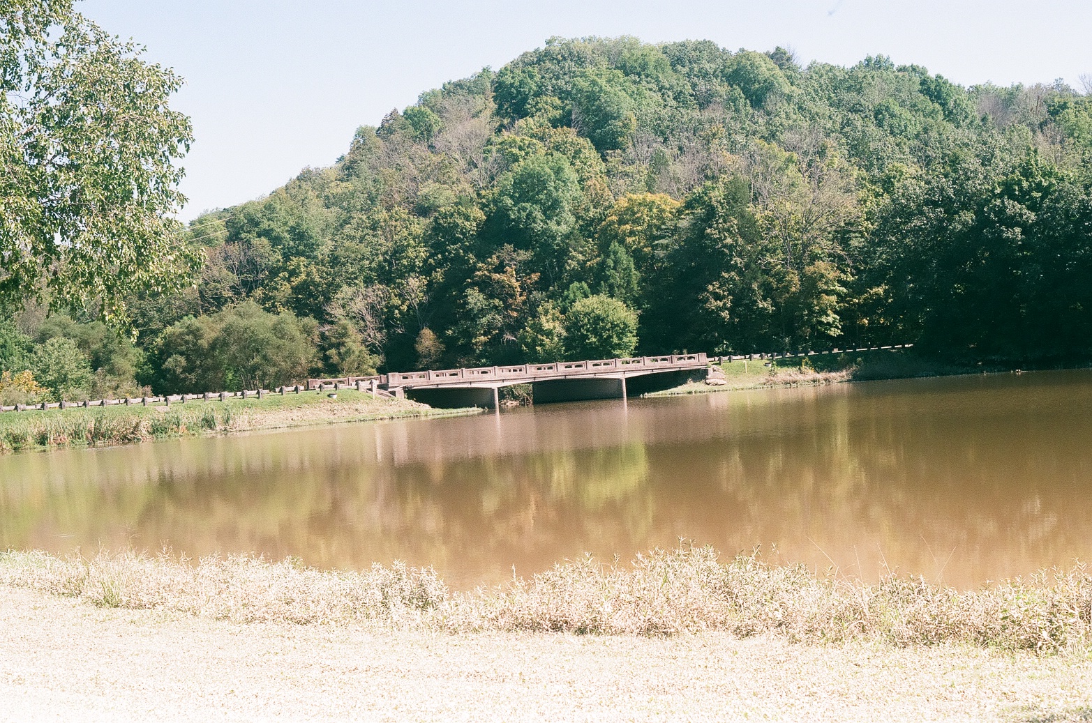

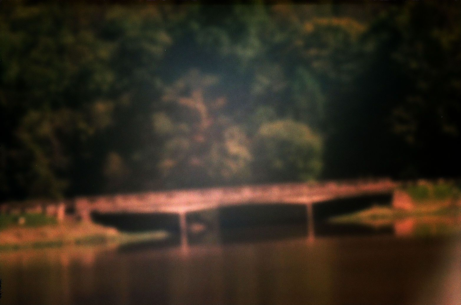

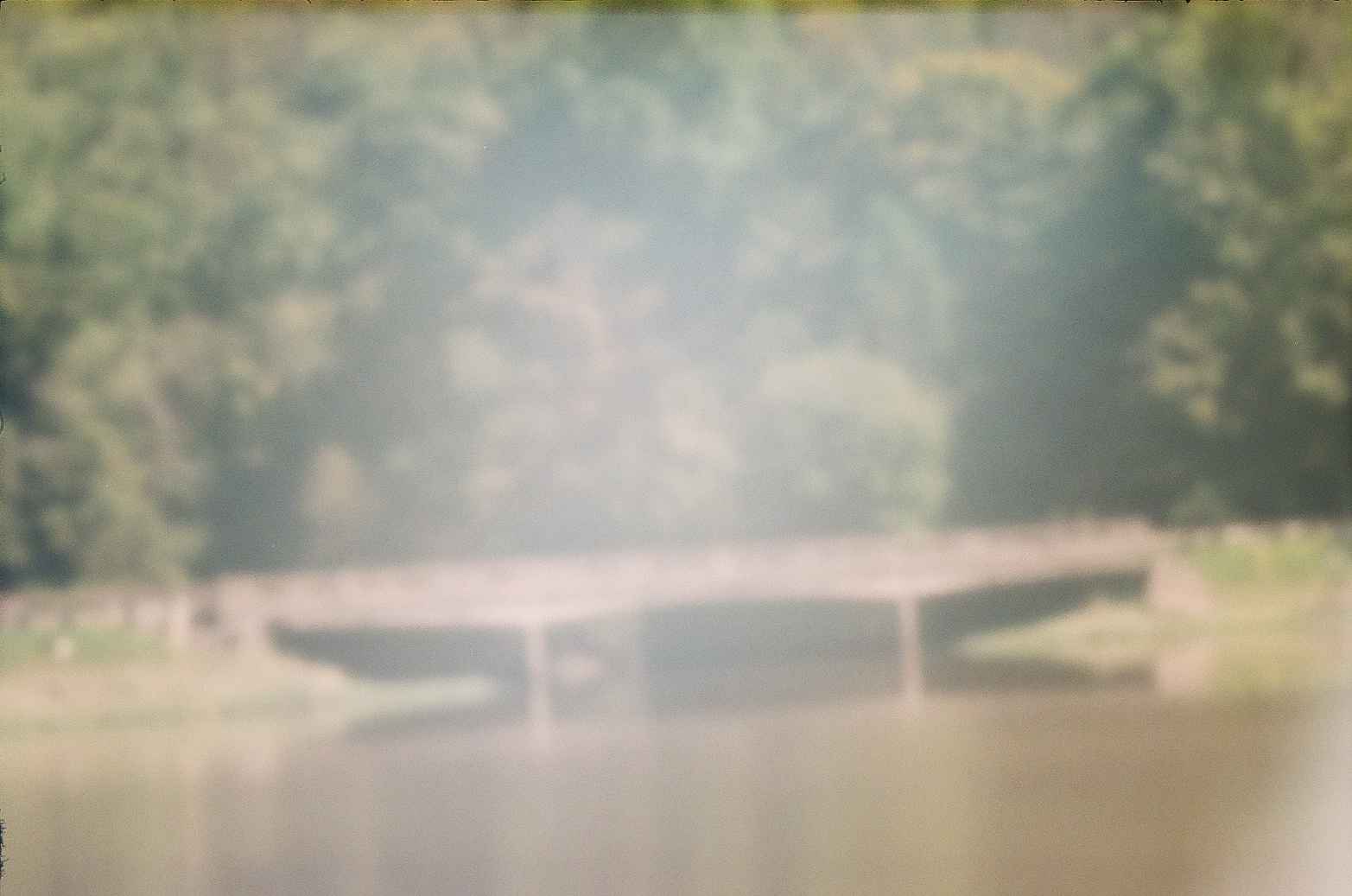

After viewing several pin hole photos that other were kind enough to post, it seems that an aperture of f 250 or smaller was needed to get a fairly sharp picture. Since I had made a .5mm pinhole, I made a black tube based on Rayleigh's figures to hold the pinhole 120mm above the 35 mm film plane. This gave me a aperture of f 240, hopefully that would give me a sharper image.
What I did not consider was, by moving the pinhole 120 mm from the film plane I had created a telephoto lens. It was not until I developed the film that I finally realize the telephoto effect. You can see this in the three photos I have attached. The first is a bridge with camera's normal 50mm lens, the second is the bridge using the 120 mm tube, f 240 tube and the third is the same photo enhanced to compensate for the exposure.
Besides the obvious exposer problems and the annoying bright spot in the middle; the end result is I have not achieved the level of sharpness I was seeking. Part of the lack of sharpness may be due to the telephoto effect with the 35 mm format.
So, I have managed, after several attempts to make a .356 mm pinhole which I fit to a tube for a 77mm pinhole to film distance or an aperture of f 216. Another roll of film awaits.

That bright spot in the middle looks like “lens” flair. Was sunlight falling on the pinhole? And for what its worth, the glories of pinhole don’t have to be sharp. LoFidelity is the name of the game.

Warning - a little pedantry follows.
"Telephoto" actually means a lens whose focal length is longer than its physical length,
So what you put together wasn't actually a telephoto pinhole, but rather a pinhole camera whose "sensor" (the film) covers only a narrow portion of the pinhole's "angle of view".
Pedantry warning now cancelled.
There are a couple of other problems that may arise from putting a pinhole at what is essentially the end of a long tube, but the biggest problem is probably the potential for unwanted reflections and flare.

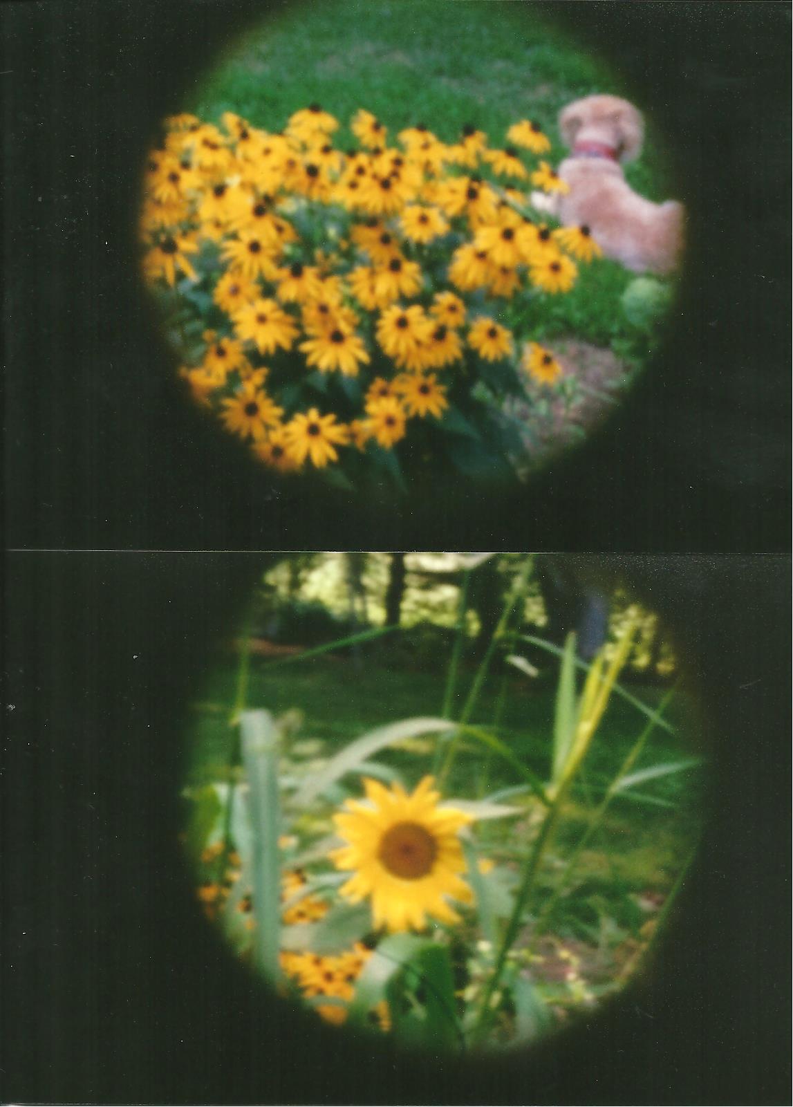

Yes, I will be the the 1st to admit that was warned about the use of the use of the 35 mm format but as you can see I am still playing with exposure vs light meter readings.
Without getting into the details or semantics of the situation, what I did not realize was the 35 mm subtends only a small portion of the light field projected by the pin hole. My very first pinhole photos were shot with a cheap kid's kit and a wild guess at exposure and an f 65 aperture. I have attached two of the better photos. After looking at the results I decided to decrease the aperture by increasing the focal length. This is where I shot my self in the foot, because any gain in sharpness due to the decreased aperture was lost to the fact that image and it's lack of sharpness. was spread out over a larger area, only a portion of which was captured by the 35 mm format. For the technically minded the focal length of the kids cameras used in the attached photos was 1.75 " with a .027" pinhole punched through a piece of aluminum foil.
So why the long explanation? I am hoping this helps some other newbie learn from my errors.
Learning never stops. :smile:

GR I think this looks great. Remember fuzziness is part of the deal with pinhole. It is the rare combination that delivers an actually sharp image.

Yes, those are quite nice -- like impressionist paintings.
