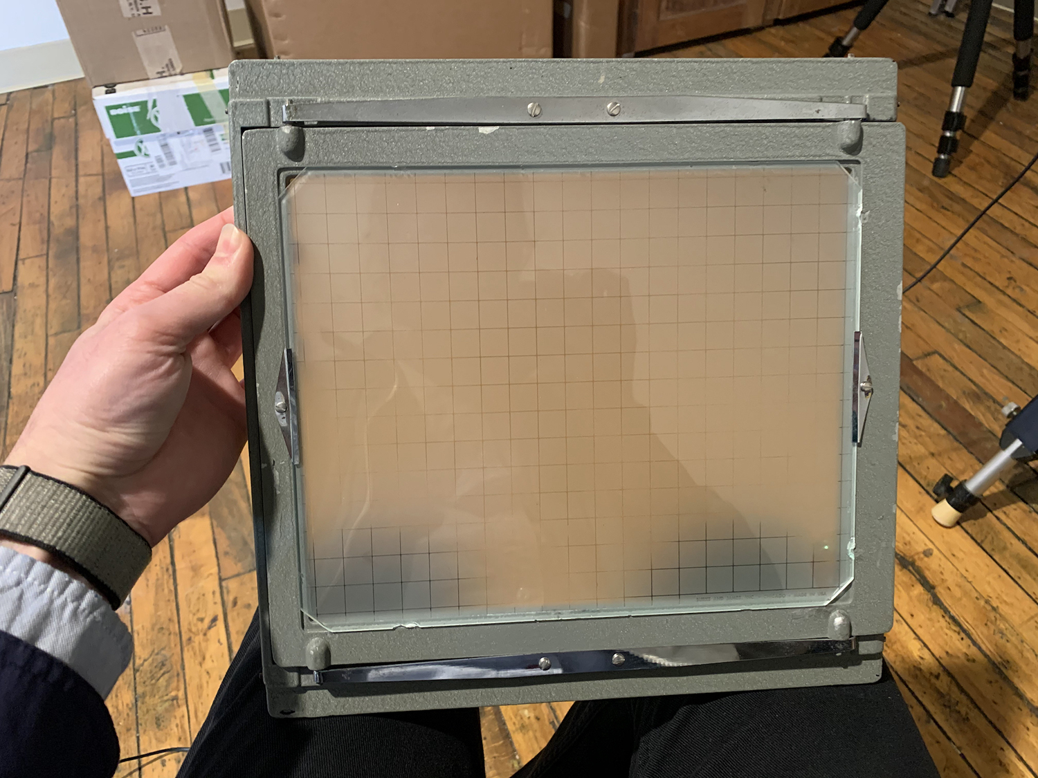

Hi All
I recently acquired an old Burke and James all metal 8x10 studio camera that I'm preparing to begin shooting with. Unfortunately, the ground glass back has no Fresnel lens and it's incredibly difficult (and annoying) to compose with in my studio where I will primarily be using the camera. So far I've done a little bit of preliminary research about the pros and cons of which side the mount the Fresnel lens on, but I'm still uncertain of what's my best option.
Any suggestions on a good Fresnel lens and a method of attachment would be greatly appreciated.

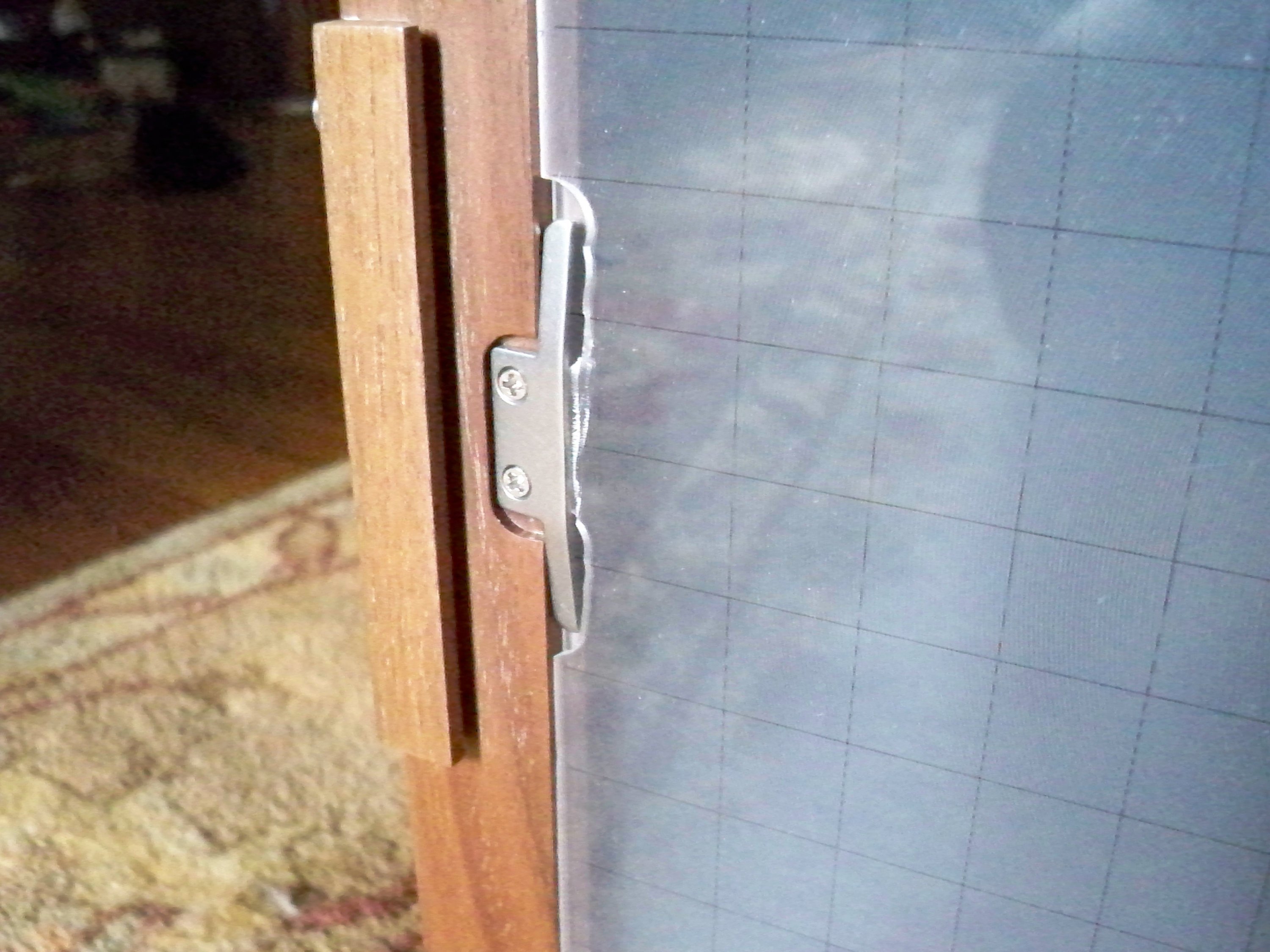

I put one of those inexpensive reading fresnel lenses on my Shen Hao just as a test. I quickly cut some notches in it to slide under the tabs that hold the ground glass in place to hold the fresnel in place while I tested it. That was ten years ago, looks like it is still in place. If anything it serves as a ground glass protector while transporting the camera.
That's the correct approach, I have two of those fresnels, but then my 10x8 Agfa Ansco Commercial View came with a NIB Beattie Intenscreen thrown in for free, and the camera & Dagor, well complete kit was inexpensive :D

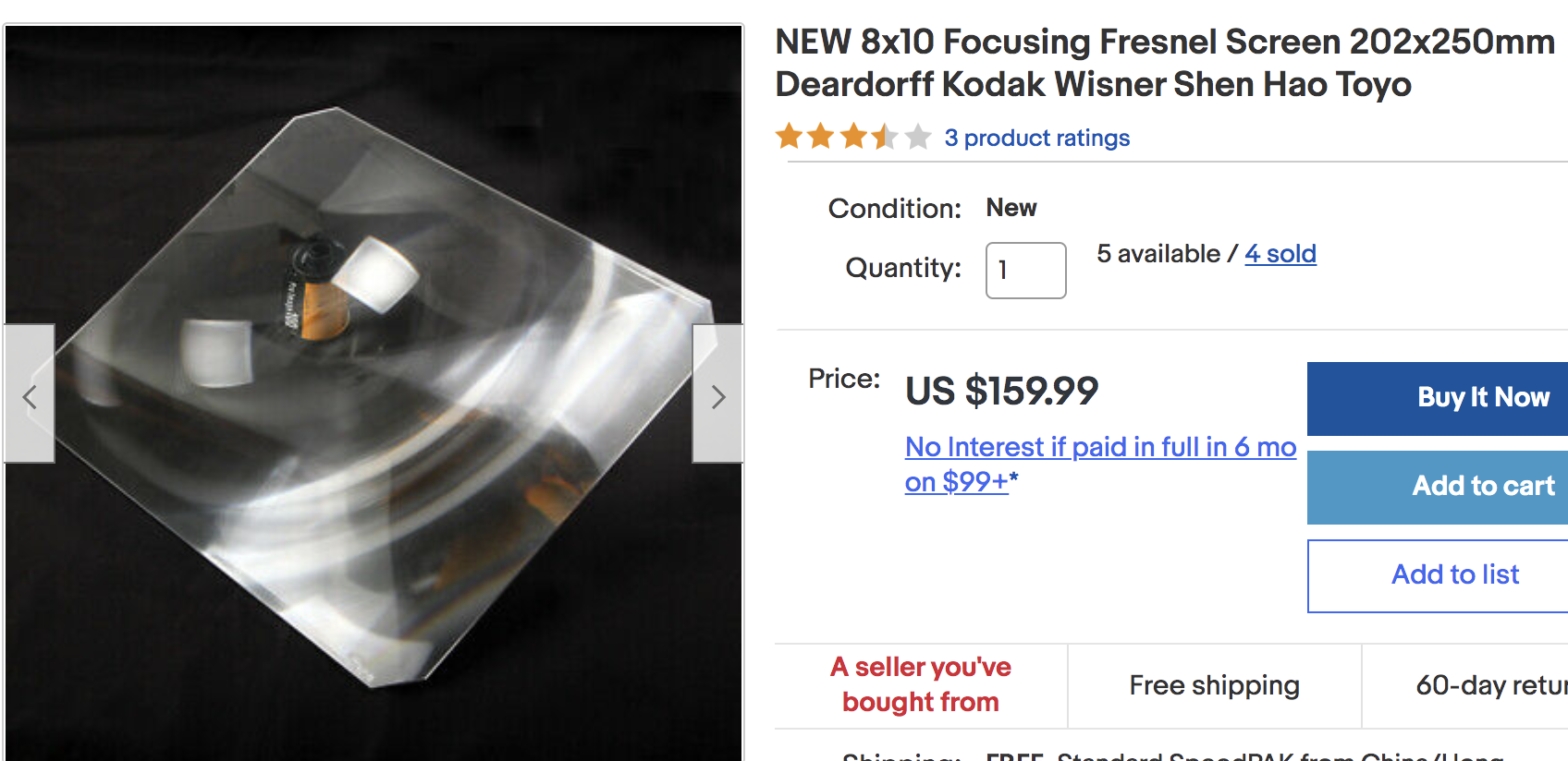

I have been thinking about one of those all-in-one combined fresnel and focus screen. But when I look at my fresnel, I see a lot of marks from my backpack. It really has been protecting my ground glass. So, if I got the all-in-one, then I'd need a piece of glass behind it to protect the $150 plastic focus screen. Then I'd need something to keep the glass from breaking....
Another option to protect a valuable plastic all-in-one focus screen is a "U" shaped piece of plexiglass that slides around the focus screen. In fact, that wood channel in the picture above is to catch the lip of the 'ground glass protector' when in place (though I don't have one).
