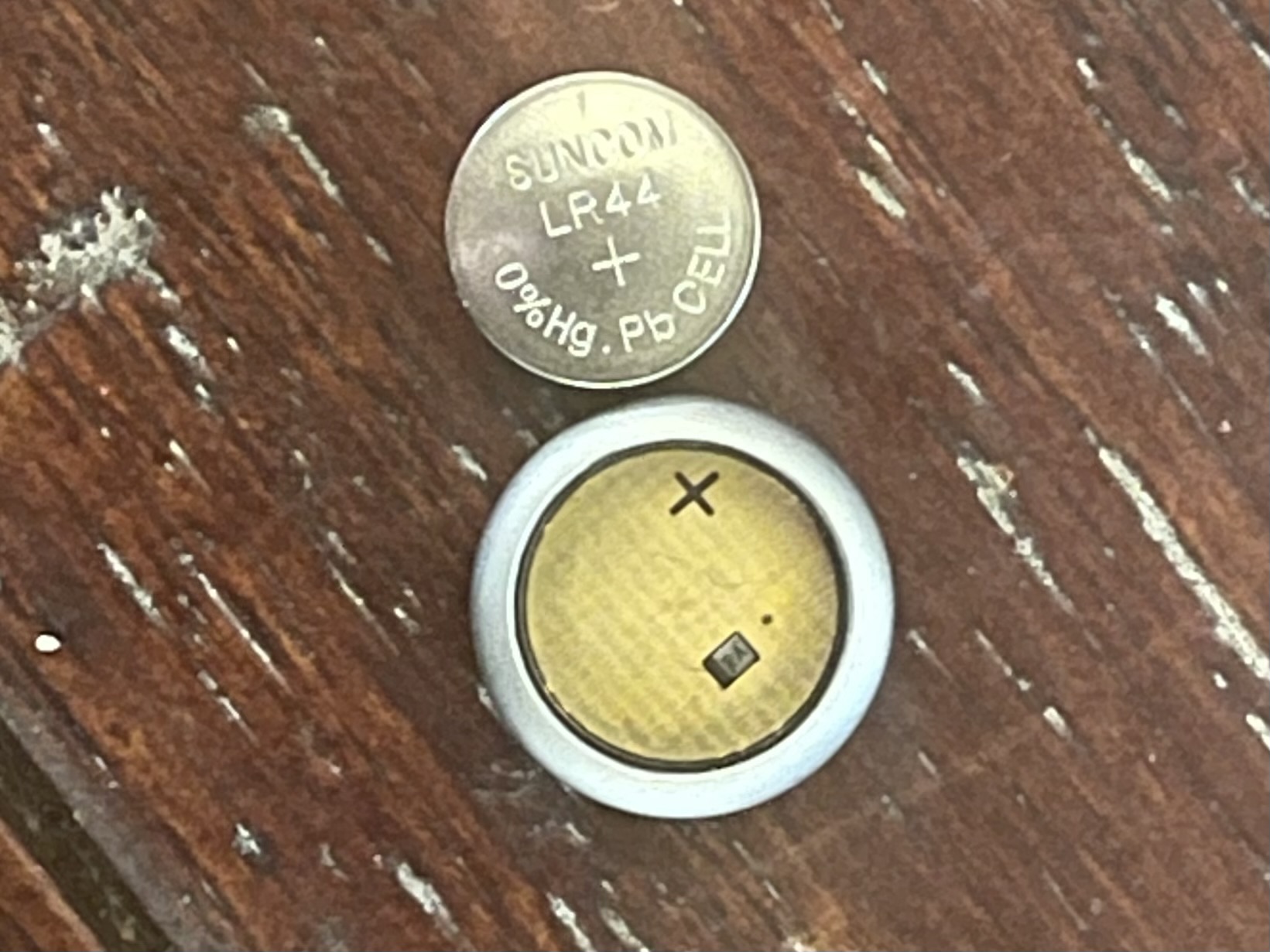

I’ll call up my local camera store and see if they would put the diode in the right place. Hearing aid batteries aren’t a viable solution due to my extremely dry climate, they last maybe a month before dying.
What adapters have you tried? On <this website> the manufacturer of the C.R.I.S. MR-9 Mercury Battery Adapter shows his adapters, when used with silver oxide 386 batteries, are compatable with the Gossen Luna Pro Cds meter. Can anyone verify if this combination does or does not work in the Gossen meter?
I am unsure of the model, but here is a picture of the adapter and a battery:

That is an alkaline battery - which is problematic - and the larger “44” size. If that adapter includes a diode, it will only output the correct voltage at one point of the alkaline battery’s discharge curve. And if it doesn’t include a diode, it will never output the correct voltage.
You need that type of adapter designed for the slightly smaller “43” or 386 size batteries in order for it to work in the two battery compartment in your meter.
When paired with the correct battery, that adapter will most likely work with a lot of equipment that are designed to use a single 625 battery - many aren’t quite as picky when it comes to cell size.

That looks exactly like the voltage-converting adapter sold by Criscam and others.
The various nomenclature can make battery selection a challenge.
The 44 (357) and 43 (386) cells differ only in height. Both are 11.6mm diameter. 44 is 5.4mm high and 43 is 4.2mm high. The height difference could be the issue with the battery cap.
As mentioned by others, silver cells are really the right idea…

You have the adapter - get the 386 batteries for it instead.
I wouldn't risk a roll of slide film with a Gossen Luna Pro meter and alcaline batteries.
