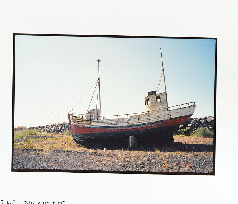

Hey everyone,
As anyone who prints RA4 (and especially anyone that is on this forum) knows, there are stark opinions out there on the differences between the few available papers for the process. I know Crystal Archive Type II typically gets a pretty bad rap, which I think comes mostly from the support being exceptionally flimsy - it feels like copy paper, the matte especially.
Opinions aside, I don't think I've seen a direct comparison between scanned prints from Crystal Archive Type II and some different pro papers - Type C, DPII, and Endura specifically. I've printed on all of these and I can say personally DPII/Type C are my favorites, but I'm curious how much better they are from a direct comparison standpoint than the Type II stuff. It's getting harder and harder to find anything else, and the prices for cut sheets of the pro stuff just keeps going up (at least at my darkroom), so I was curious how worth it it really is to pay the premium or if I should bite the bullet and invest in some Type II in bulk.
