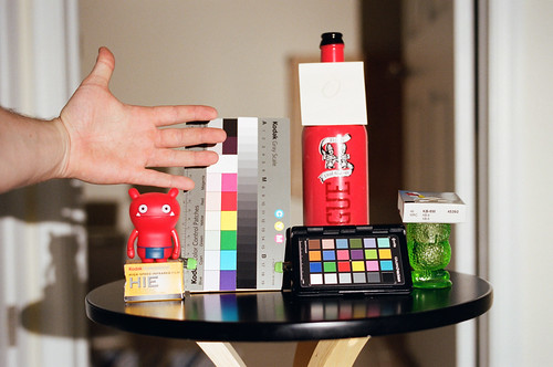

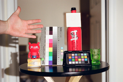

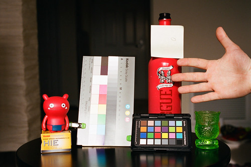

I haven't got a KB 6 filter (80D) but I do have an 82B that I was thinking of using as a compromise are they quite similar?
It's possible. But like I said, in many cases you can just shoot with no filter and correct it in post. It might not be 'perfect', but often plenty good enough. I see you were already in my flickr stream, but I'll post these examples here anyway.
I'd draw your attention to the blues and the reds in the below shots, as well as the skin tones. Obviously, the blues look better in the daylight shot and the shot with the KB6 filter.
Not as immediately obvious, the reds also look better in those shots. That's probably because the blue layer was boosted to compensate for the lower color temperature of the tungsten/no filter shot. Which ends up adding blue all over the picture. And since the red colors register primarily on the red sensitive layer of the film, they aren't as affected by the lower color temperature and lack of blue light. This is unlike a neutral gray, which is nominally registering on all three color sensitive layers equally in proper lighting, and overly warm (too little blue) in mismatched tungsten lighting. So adding more blue to adds more blue to the red (duh) making it more purple, while at the same time moving the too-warm grays to a proper neutral.
Note, full filtering with an 80A would provide better results than the 80D. If you can afford to, put the 80A filter on your lens and be done with it.
With that being said, the unfiltered shots look pretty good in my opinion and are perfectly usable for me. 99% of the time I just shoot whatever film I have (sans filter) in whatever light I'm in and don't worry about it at all. But I don't shoot product shots, etc., where ultimate color accuracy is needed. Lastly, I'll say that in my experience Portra 800 is also up to the task. If you need the extra stop of sensitivity and can handle the extra grain, it's a wonderful film.
Portra 400 in daylight:
Portra 400 proper exposure + hand by ezwal, on Flickr
Portra 400 in tungsten (3200 K):
Portra 400 Tungsten proper exposure + hand by ezwal, on Flickr
Portra 400 in tungsten w/ KB6 (80D) filter:
Portra 400 Tungsten KB6 proper exposure + hand by ezwal, on Flickr

I do just want to clarify something. I'm not trying to make myself to be any kind of expert here. I've just found that after doing some simple testing (and blowing $40 on a filter), 99% of the time, I don't worry about tungsten lighting because I'm ok with the results I get.
Markster
Dec 30, 2010
307
Denver area
Tim, just to clarify, that's without post-correction, right?
Also does that filter add a bit of polarization? I notice in the unfiltered the color card is washed out with light. I don't know if the filter changed that in the following pics or if it's just the random placement catching the light in the worst way?
Tim Gray
Sep 2, 2006
1,882
OH
These are with corrections. They were not wet printed, but I can tell you nothing fancy was done in photoshop or in the scanning stage. I would think that color balancing during wet printing would get you basically the same results.
Glare: just ignore the glare. I'd be surprised if the filter affected polarization in any meaningful manner. I shot these with a rangefinder and wasn't particularly mindful of reflections on the cards in any of the shots. After I got them back from the lab, I had a "Doh!" moment. But I don't care enough to shoot them again :smile:
