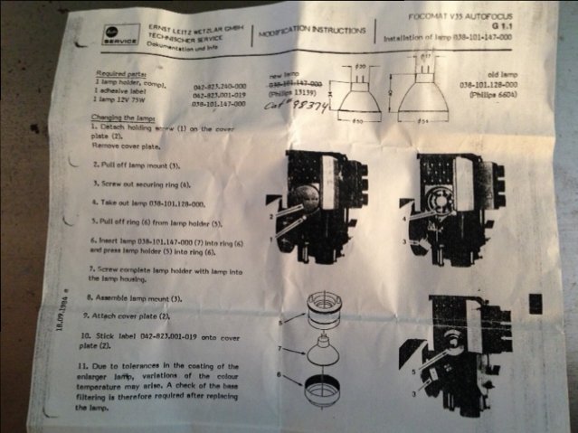

I bought a Leica V35 recently...got it for a steal...it has had some issues though, which I eventually did a re-wire
on to solve. Ok, so here's the deal...the old bulb (Phillips 6604) is no longer available, and was replaced by the Phillips 13139 12V bulb.
The housing which holds the bulb is accessed by removing the small panel on the rear of the head...this will expose
the threaded housing-it unscrews and this exposes the barrel which holds the bulb. Because the new replacement
bulb was a different size, Leica offered a modified housing...if you remove the bulb, and it has the code listed above,
you have an updated unit...if not, they are available, but not easy to find.

Here is a Leitz parts breakdown of the lamp replacement and redesigned housing screw cap.
