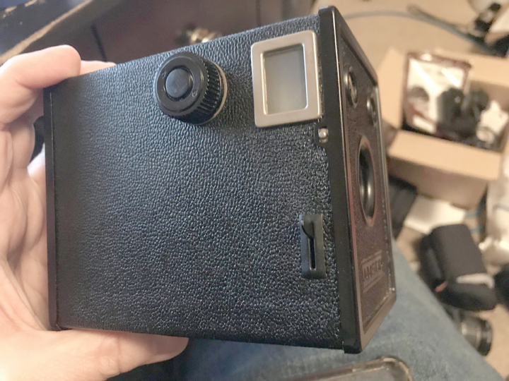

Just picked up an Ansco Cadet B2. Despite the shutter being broken where it won't snap back, I still think it's usable. However, the slow shutter (somewhere between 1/30th-1/60th depending on which resource I check), combined with my shutter having issues, makes me think getting a good shot even on a tripod might be extra difficult. Does anyone have a way to improve triggering the shutter for box cameras for smoother operation and less shake? Like maybe using a rubber band to pull down the shutter or something?
My shutter failing in case anyone wanted to see it.

The front with the lens and shutter should separate from the main body. Please provide a picture of the side of the camera.
Video of the shutter inside

Have you put a very small drop of light machine oil on the pivots?
The short spring on the operating lever/shutter blind appears weak.
Remove the springs then heat treat them according to the last steps in this spring making guide http://www.deansphotographica.com/machining/projects/springs/springs.html
It will increase the springs tension about 25% to 30%.

I have this same model. First thing to check is that the shutter lever is not binding in the slot in the side of the camera. These can get bent and bind up the lever. Then try moving the shutter lever without triggering the rotating disc. It should move back and forth under the pressure of both springs quite easily. If not, it may need a drop of sewing machine oil on the pivot, but these are designed to run dry. The shutter speed itself doesn't look much different than mine, I usually figure on 1/25th or 1/30th on the simplest box cameras like this.
The technique for a solid shutter release is to hold it with fingers of both hands underneath and thumbs facing forward on the sides. Then a steady squeeze of the thumb. Oh, and a beer belly makes a nice prop.

The picture of the other camera shows differences in the shutter plate as well. Without knowing the exact model, I would say it may not work like yours. Ansco made these over many years in both Ansco and Agfa names. They often had other features such as different apertures, time exposure, and portrait lenses.
I would concentrate on why the shutter lever is binding. You can carefully unhook the spring between the shutter lever and the rotating plate. The shutter lever should then move easily back up by spring pressure.
If you can't get it to move correctly, the rotating plate is still working and it will take pictures, you just have to move the lever up after every shot

Upon closer inspection, you are correct. He's got the Agfa version and I have the Ansco version. All these versions have not helped me figure this out. I'm still not 100% certain the way it is functioning isn't correct for this version. I've seen a few videos that suggest it doesn't spring back, and others that do. Sigh.

The photo you posted in post 3 with levels adjusted to show the lever in its slot more clearly.
unnamed.jpg the lever appears good.
Looking at it isn't going to fix it. Take a pair of needle nose pliers and compress the right leg of the lever spring until it is disengaged from the shutter lever then lift it up over the lever seat and slide it out of the shutter slot.
post a picture of the spring.
Operate the lever, it should move easily and smoothly.
