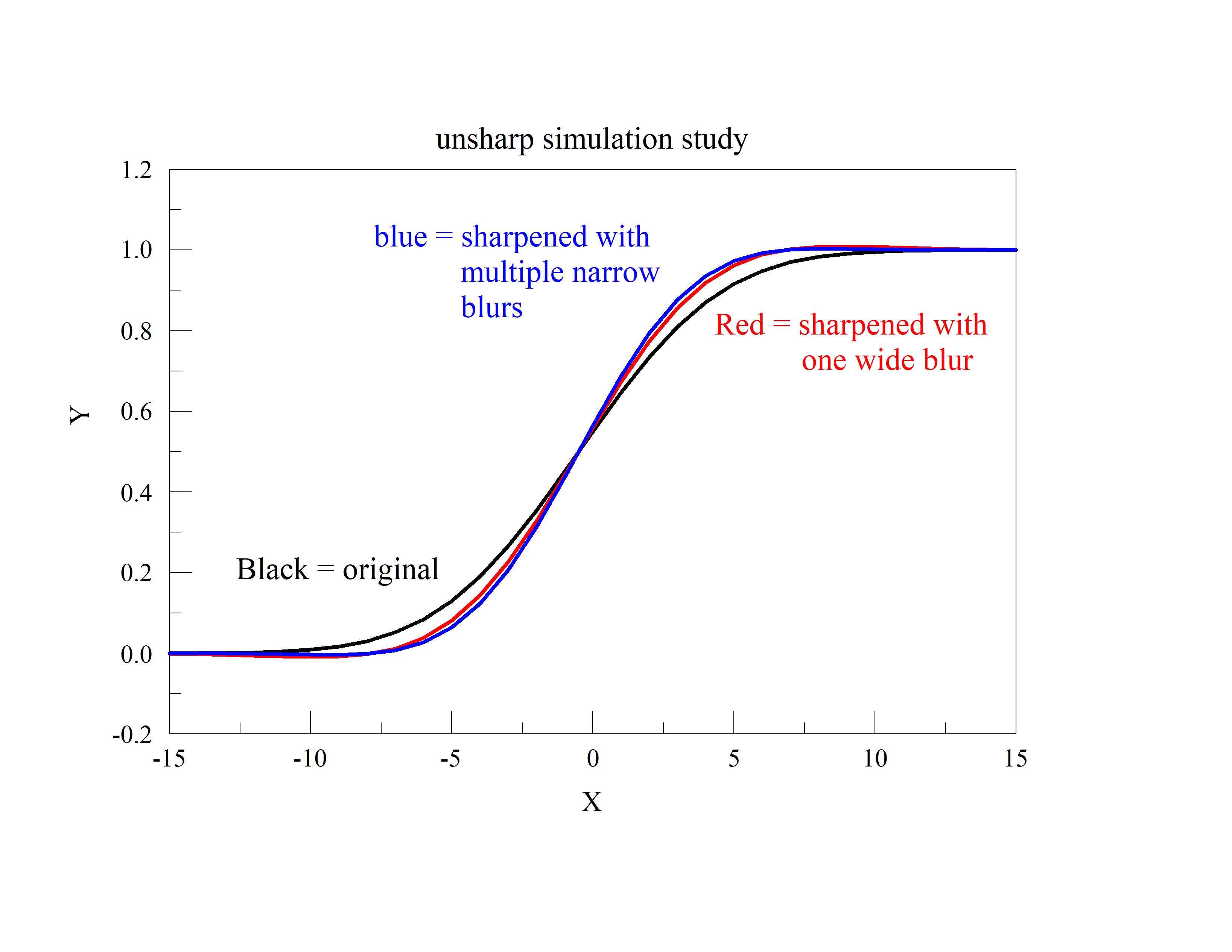

I have been giving a lot of thought on how to improve sharpening functions, specifically on how to sharpen while minimizing halo formation. I focused on using unsharp masking functions and have done some computational experiments.
Here is what my experiments are showing me. For a given amount of sharpening it is better to sharpen several times using narrow blur functions than one time using a wide blur function. This figure gives an example.
What the figure is showing is using successive unsharp functions using a narrow blur function produces less overshoot than using a single wide function.
Specifically, when applying narrow operations with narrow blur multiple times, the peak of the overshoot is located closer to the center edge being sharpened and amount of overshoot is less compared to using a single unsharp operation using wide blur. This means that the halo will be less apparent.
Also the slope in the transition region is steeper when using multiple narrow blur functions.
Overall, one can conclude that it is probably better to apply successive unsharp operations multiple times using narrow blur than a single unsharp operation using wide blur.
I can post a more detailed explanation of the calculations if anyone is interested.
Any thoughts?

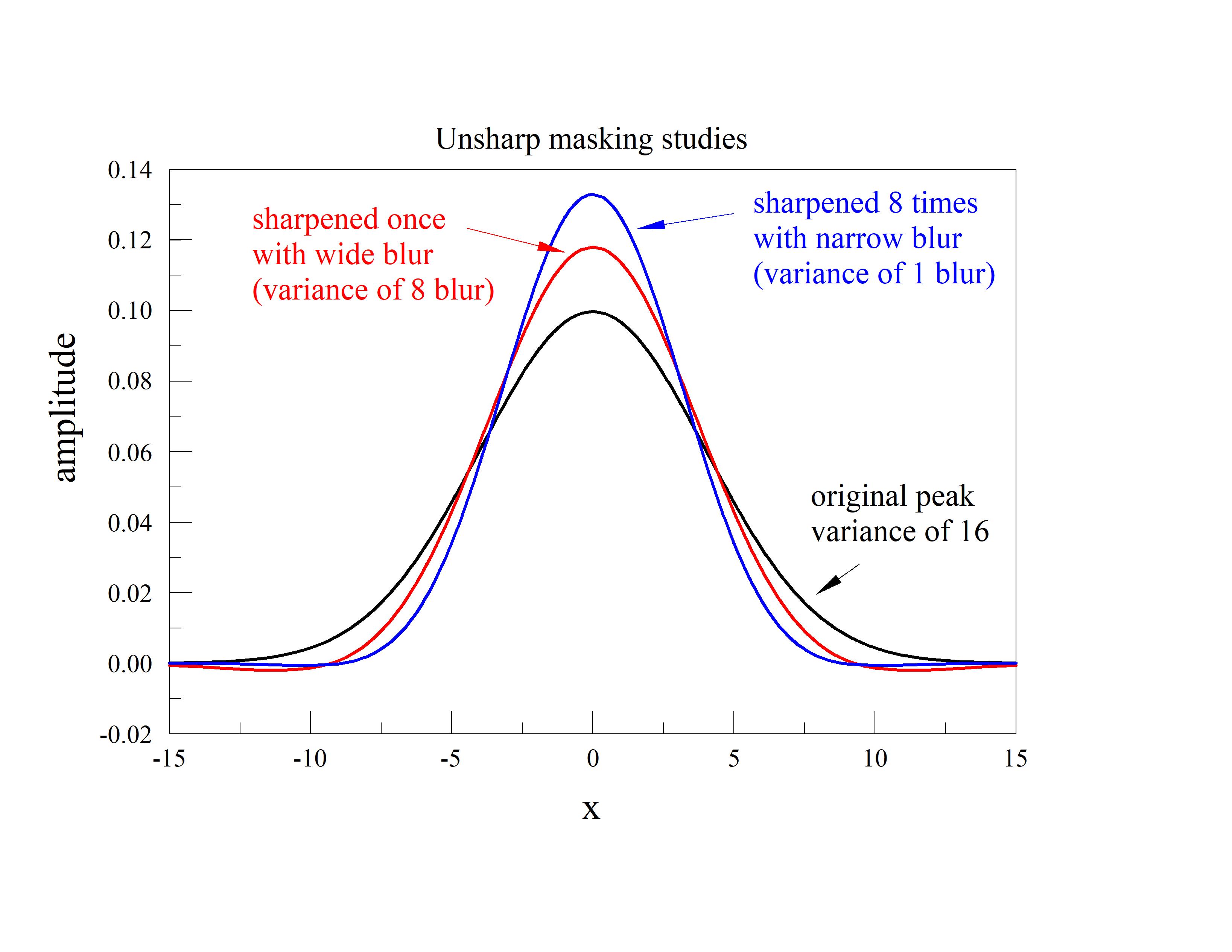

OK. I did another study.
Here are the details. I started with a gaussian point with a variance of 16 units.
I did an unsharp mask procedure using a gaussian blur function with a variance of 8 units, applied once.
I did a second unsharp mask procedure using a gaussian blur function with a variance of 1 unit, applied 8 times.
(These are not the same parameters I used in the previous study, and for presentation purposes I am using an original function as a blurred point rather than a blurred edge.)
The resulting widths of the two sharpened functions are the same, as measured by the second moment, which ended up being 8 units. The second moment is basically the same thing as the standard deviation for these, except for a technical issue, which is that the sharpened functions are not, strictly speaking, probability functions, because they have undershoot in the tails that goes negative. That technical detail is not important when comparing the widths of the functions. Areas of the two peaks are also the same, as measured by the integrals of the functions.
The important observation is that, even though the degree of sharpening is the same using the two sharpening procedures, the second procedure produces a better result because there is less undershoot, (the degree of undershoot is less, and it occurs closer to the center of the peak), the slope of the curve is steeper, and the peak height is greater.
This implies that when sharpening you will produce fewer sharpening artifacts (like halos) if you sharpen multiple times using a narrow blur function than if you sharpen once using a fatter blur function.
I remains to be seen how well these results hold up when using different functions. For example, if the blur in the original image is not gaussian, and also how the width of the blur in the original function compares to the blur used to sharpen the picture in the unsharp masking procedure.

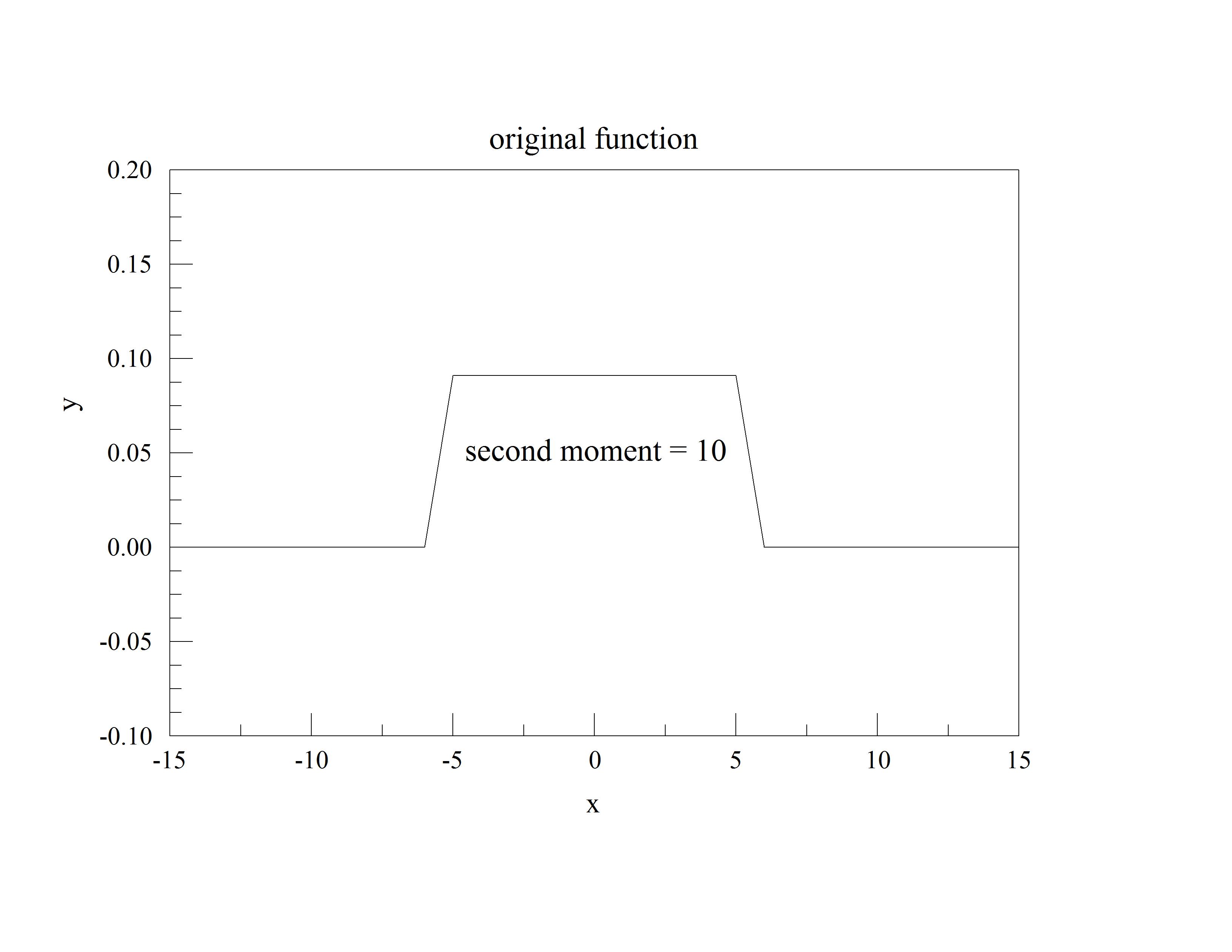

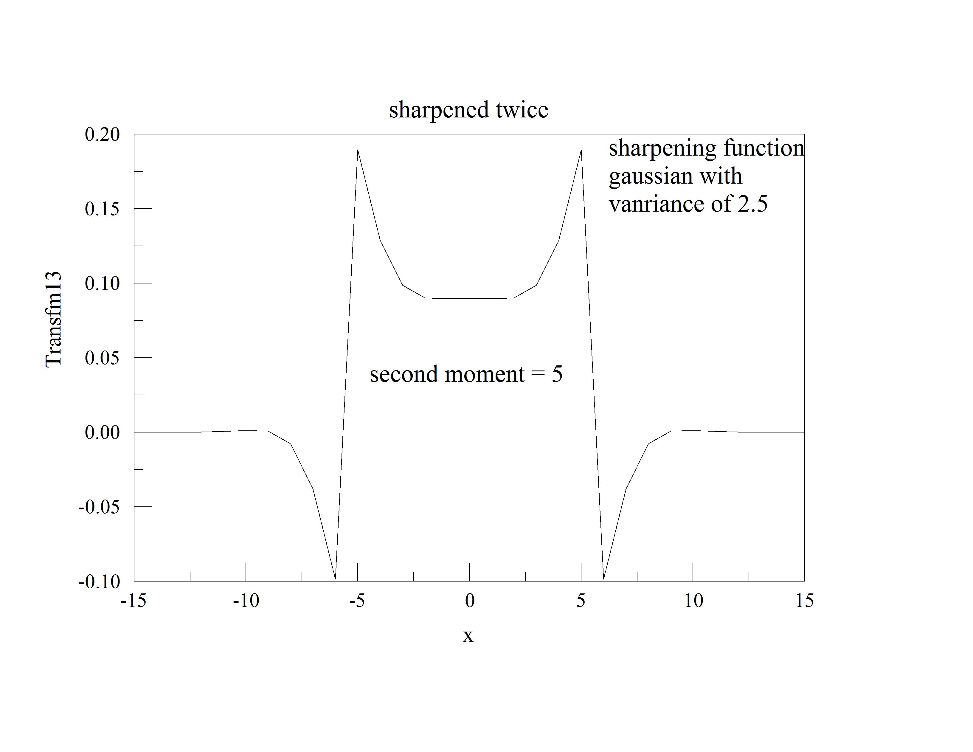

Let me ask a question about the blobs. Were they similar to boxcar functions? A boxcar function has a constant value within some interval (such as 8 points wide), and zero values outside the interval.
In an image, in order to avoid negative values, one would define the image by starting with a constant value everywhere, and then add another constant value within an interval (such as 8 point wide).
If you try to sharpen a boxcar function it doesn't work very well. Basically, you get big amounts of overshoot and undershoot (halos) at the boundaries of the boxcar function.
I have calculated an example. I am attaching three plot. The first is a boxcar function with a variance of 10. The second is a boxcar function after a single sharpening using a gaussian blur function with a variance of 5. The third is a boxcar function after two sharpenings with a gaussian blur function of with a variance of 2.5.
Basically, all the sharpening did was add halos. The halos on the one that was sharpened twice had greater amplitude but didn't extend out as far from the edges. (please excuse the typo in the figures, "vanriance" should be "variance". )
