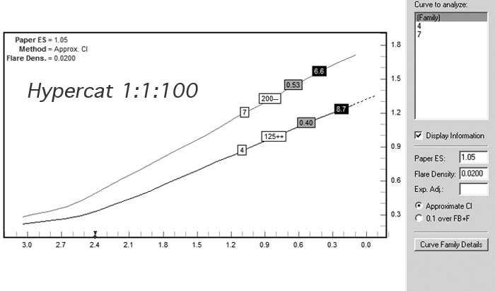

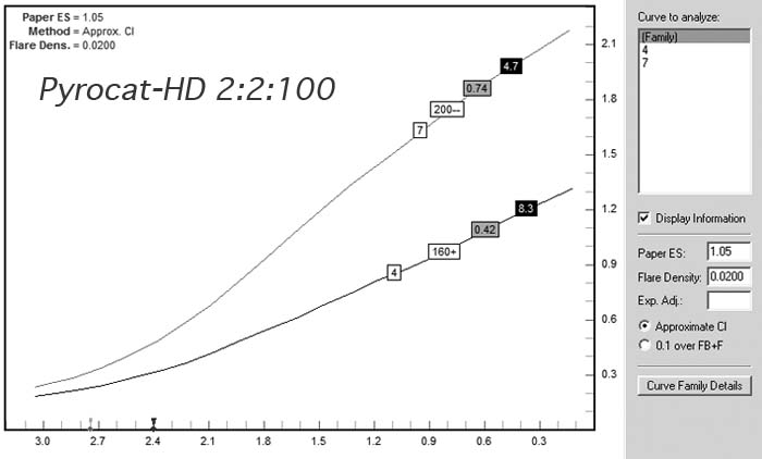

I did a comparison of Hypercat at 1:1:100 with Pyrocat-HD at 2:2:100. The dilutions were chosen to provide as close as possible the same amount of pyrocatechin in the working solution.
Film was FP4+. The negatives were exposed identically with a light integrator, and were developed together.
Analysis based on blue densitometer reading.
Conclusions.
B+F Pyrocat-HD lower than Hypercat, 0.10 to 0.17
EFS Pyrocat-HD slightly higher.
Energy Pyrocat-HD higher, increasing significantly with time
These results do not appear to agree with Jay's findings, but I am confident that they are correct. I draw many conclusions from this test. If you have questions please let me know.
To understand the curves, as you go from left to right the data is 1) time of development, 2) EFS, 3) CI, and 4) value for SBR.
I won't comment on grain and sharpness at this time since this determination will require another test exposing and developing the film in the two developers for the same contrast. My personal opinion is that Jay's Hypercat is much improved over the older formulas that use pyrocatechin + sodium hydroxide, but it is no match for Pyrocat-HD, at least in the area of B+F, energy and EFS.
Should you trust my test results? You decide.
And BTW, regardless of what you think of the developers, you gotta love that long straight linear line of FP4+. The straight line of course in the film, but both of these developers are able to take maximum advantage of it. I mention this because some developers do not.
I also did a test with HP5+ in the two developers, with similar results.

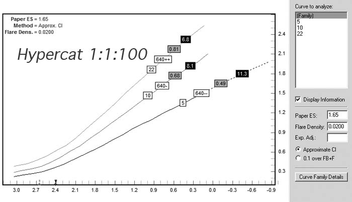

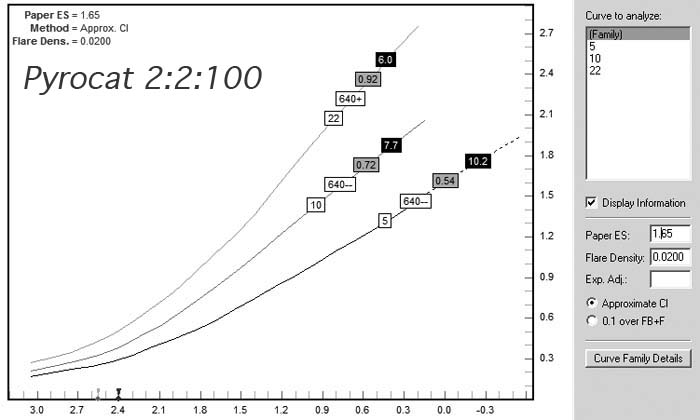

(The HP5+ files are attached. They were set up for AZO 2 with a ES of about 1.65.)
