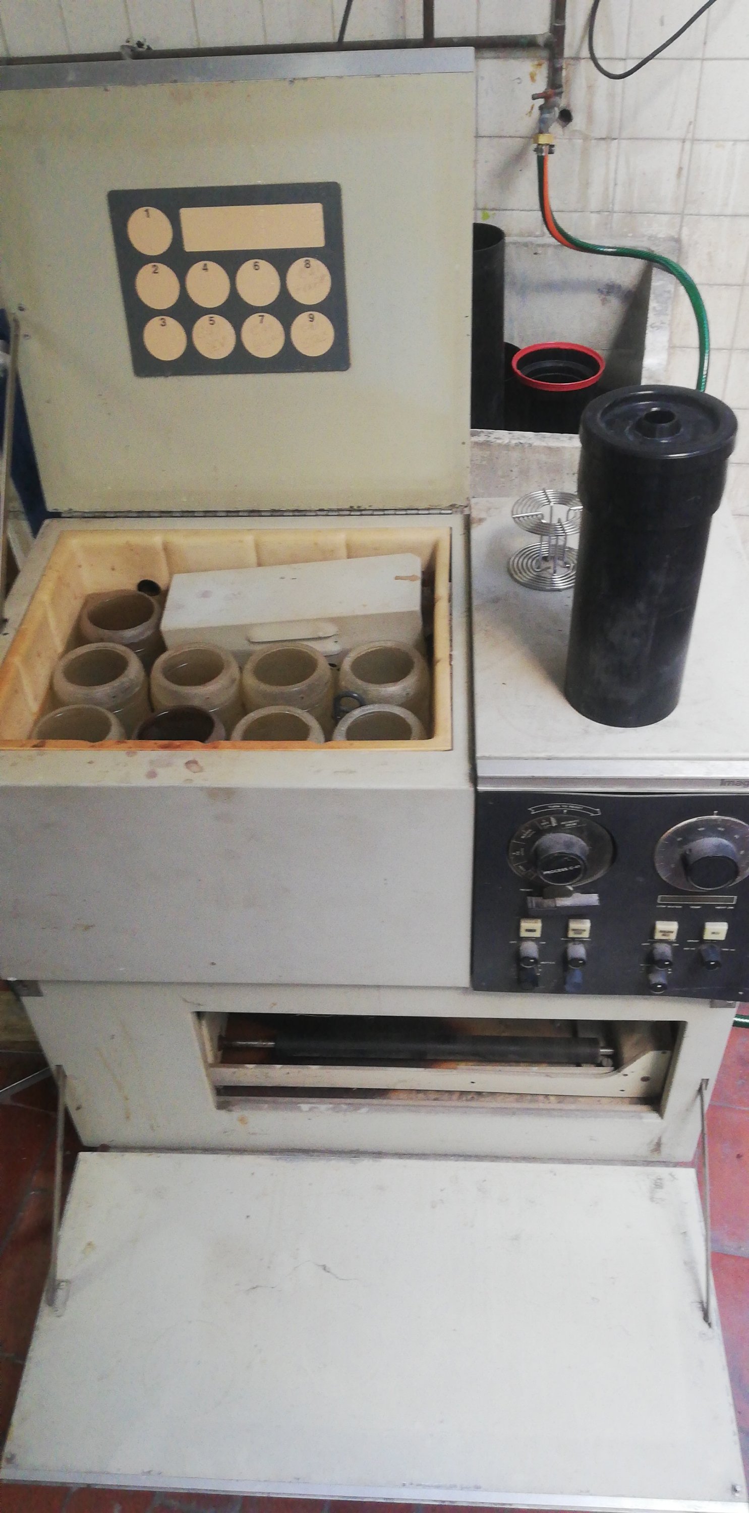

Hello eleven-years-ago Internet! I'm on to bringing back from the dead an Image maker. It has no discernible brand printed anywhere around. (Not it says "II".) Mine has 9 bottles and not 8. But I assume it must this apparatus we're talking about. I've just tested it over and over using only plain water in all 9 bottles. Yet, I have not tested the actual process of any available programs (B & W, C41, E6 and sheets).
I think I've figured out most of his it works, but I'm still confused about two things:
1) There's a dial for DRUM 60 ml / 120 ml / 180 ml. This is confusing since none of the the drums I have (one small, one medium, one large) is nowhere near that capacity. They're all of course far, far more voluminous. So what exactly is this to be set for? I can only assume that 60 ml is for the smaller one, the 120 ml for the medium sized one,. etc... but, and here's the next question:
2) All chemicals drain completely from the bottles as soon as it's time for them to go into the tank... and the valves down the bottles stay open for a while as if they're demanding much more liquid... No matter what the size is.
So I wish someone here could help me out with that... I'd looove to try it ASAP.
BTW... that alarm it has... Is that to let you know that a bottle needs to be replenished or is it a warning to let you know that it's about to drain chemistry you might want to use again?
Thanks everyone! :smile:

Can you post a photo of your machine?

As I stated above you got an older model, still with those pinned-drums, whereas the OP's model takes barcode cards. But for the rest they seem similar.
