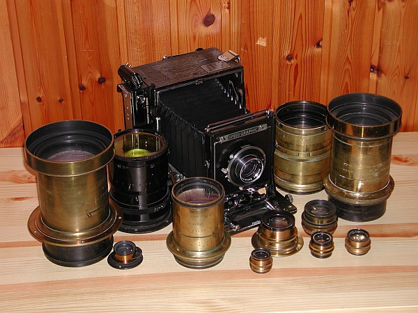

Assuming this photo was made in the UK, a lens like the one on the left here is far more likely: A Ross Cabinet No.2, a 14" f:3.5 Petzval lens. A post card is about "cabinet" size, and a 14" lens would give a good working distance to the sitter. The very good sharpness in a very limited area is also a hint that it might be a Petzval.
The print could be albumen, collodion/silver, gelatin/silver POP, or even an early "gaslight paper". It's difficult to tell the difference on a PC screen.

Hi Ole
Image was definitely made in UK. Family was reasonably poor so I think it would have been done as 'cheap' as possible.
Thats a nice selection of lenses you have thee
