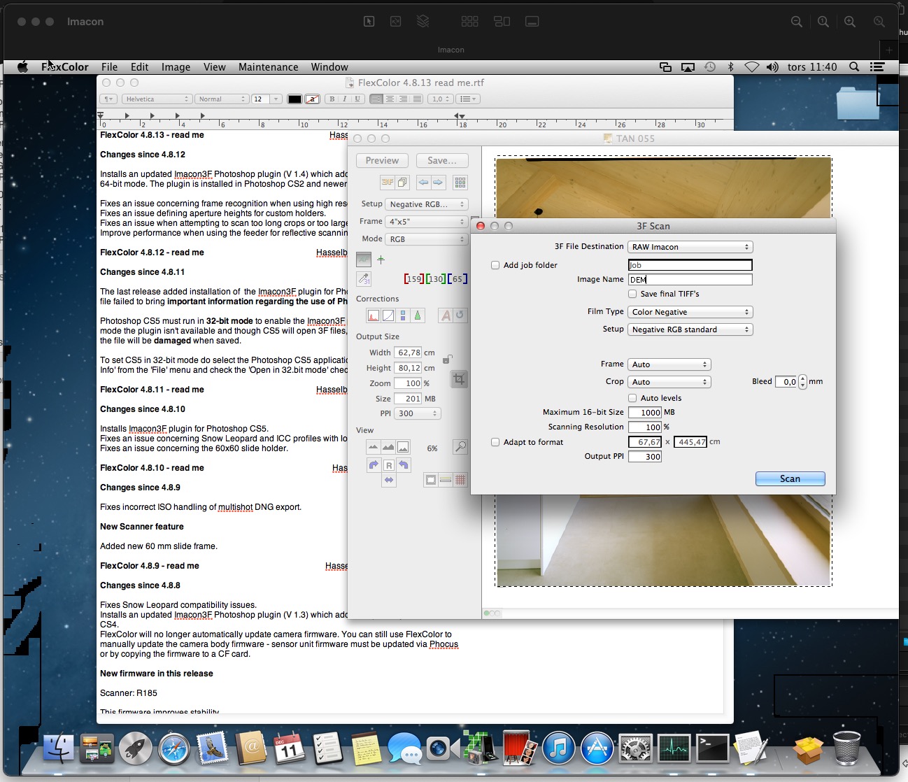

I guess you got it fixed. Just for anyone wondering. Ive been using various versions of the Imacon scanners for more then 15 years. Mainly the Flextight I and II and since 5 years the Imacon 949. This is the info I gathered and tested. Other versions might work as well...
The newest software version that will work for the 949 and 848: FlexColor 4.8.13.
It runs on OS X 10.4 -> OSX 10.8.5, Mountain Lion. No newer Macs then late 2012 works natively.
Im using a dedicated Macmini 6,1 (2012) i5 with mountain Lion installed.
I use remote screen (built in Mac app) to manage the scanning without having a extra screen, just connect it to the network and enable screen sharing.
As with all firewire/scassi. The scanner needs to be started before the computer.
To scan:
- Press 3F button in Flexcolor and scan the negative according to the manual.
- Rename the .fff file to .Tif (photoshop does not support 3F anymore, but it's actually a tif file).
- Open in photoshop and invert.
- Add histogram and pull each color hi and low points to beginning of the histogram.
- Done.
I highly recommend this scanner and this process. Very simple and makes the most of the scanner. I would say on pair with wetdrumscan quality. Minimal with dust and very fast on the newer machines. The Flextight 1 & 2 are quite slow. The 949 and New X5 are basically the same machine but much much faster.
