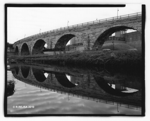

This is exactly how I contact print my 4x5 negatives: I use a 4w nightlight bulb held over my head, the negative and paper (Ilford MGIV) go between two 5x7 pieces of glass, with a gaff-tape "hinge" and one end, and a smaller gaff-tape "latch" at the other. With the negatives and glass holder laying on the floor, my exposure times seem to be in the :30-1:00 range. I do not have too much of an issue with air currents moving things around as I close the glass cover on my holder. I made a cardboard frame just slightly larger than 5x7 with a slightly larger than 4x5 cutout to give myself a nice black edge around the image, leaving the rest of the paper white. Here's the result:
