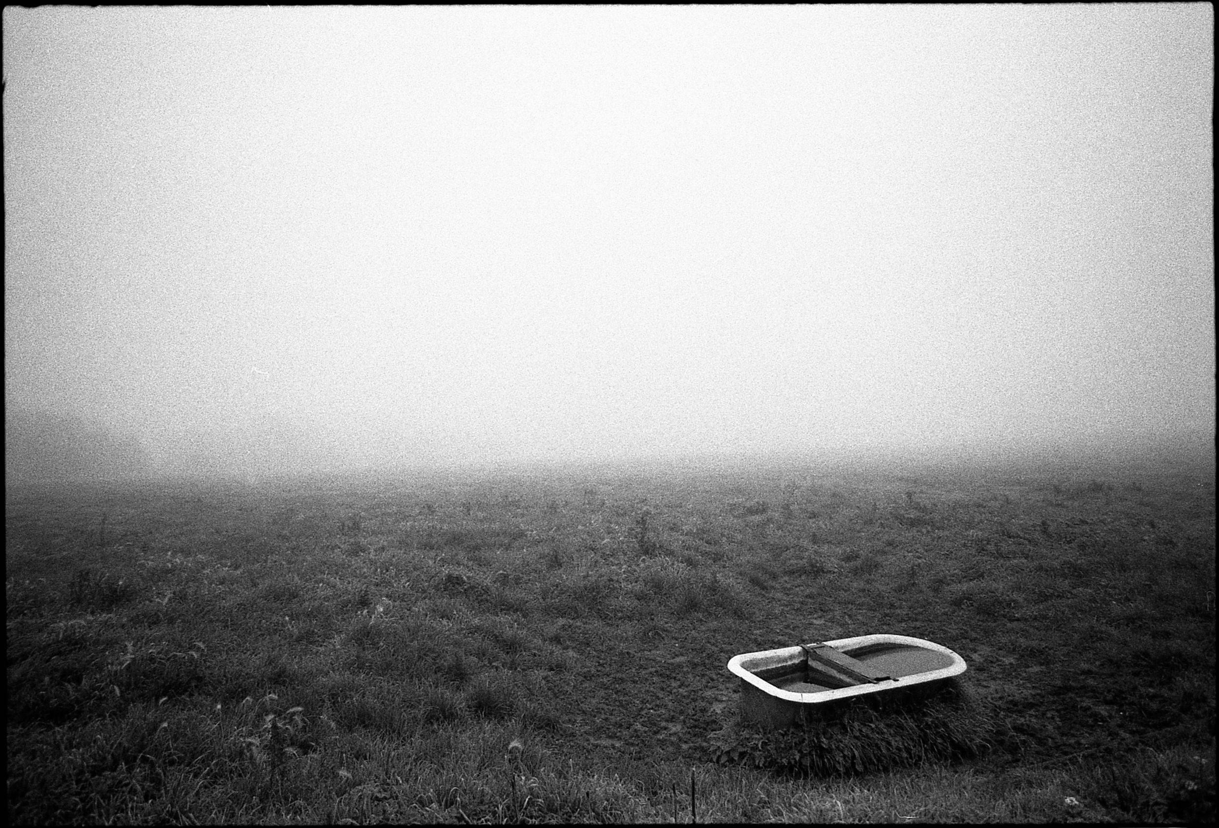

This has been bothering me for a while, but the last roll of film I developed really pushed me over the edge.
Basically, no matter what I do, I seem to get a right ton of grain more than I think I should be getting considering both the speed and format I'm shooting. I'll start with an example before getting into details.
This first photo is shot on my Canon EOS 30 on Ilford HP5 shot at box speed and developed locally at a lab.

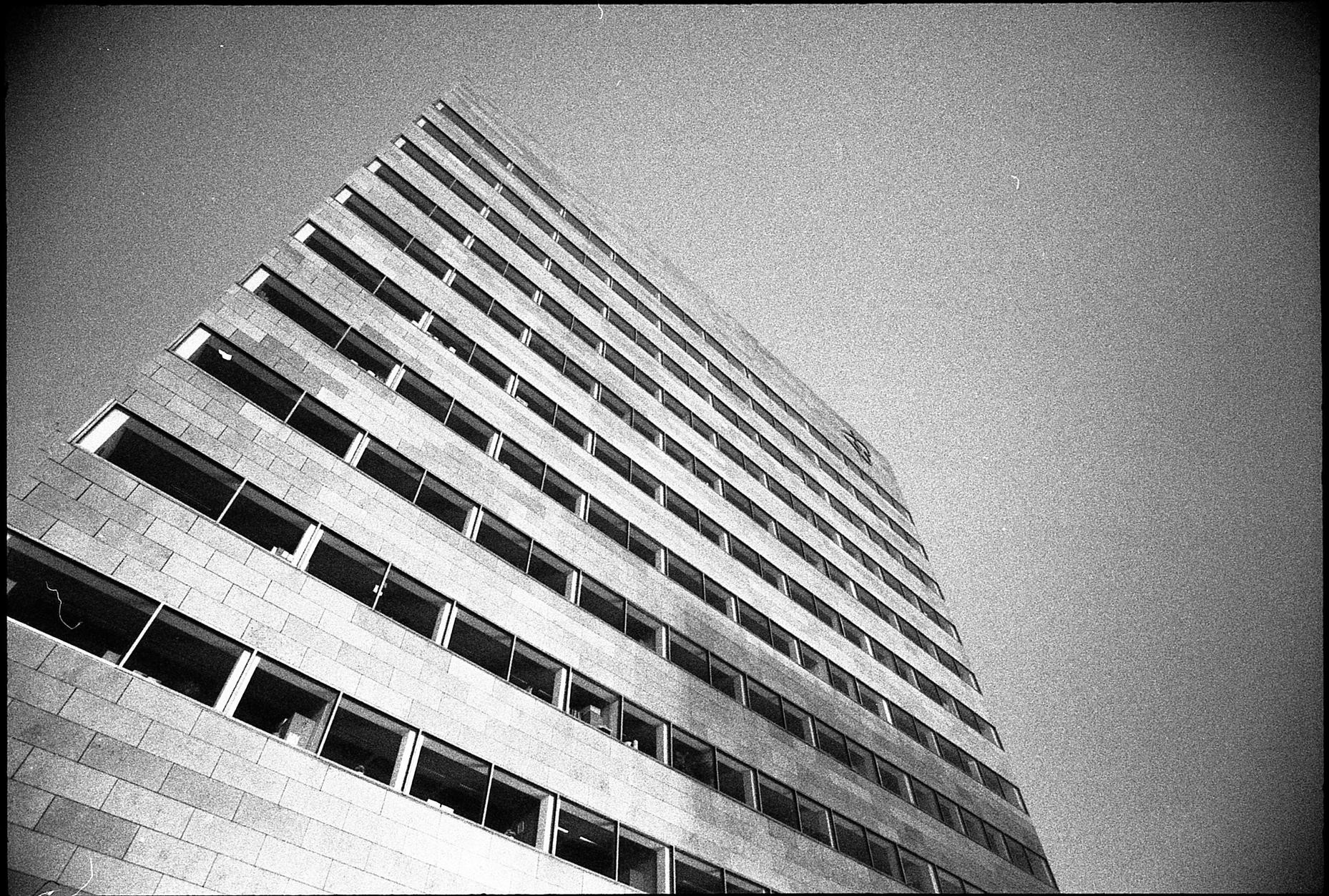

Now this second shot is shot on my Mamiya 645, again shot at box speed but developed by me in LC29 1:29 for 9mins, with constant agitation for the first minute (could this be where I went wrong, too much initial agitation?) then 10 seconds every minute.
This was the most careful I've ever been with developing regarding temperature controls too. I normally get the developer to the right temp but use stop and fix at room temp. I thought this may have been where I'd gone wrong, but now I don't think it is.
This got to bothering me after seeing photos people have taken on 35mm with their 400iso films pushed to 800 and 1600 ISO and there still being less viable grain, especially in the highlights than I'm getting here with my 6x4.5's. And the grain I'm getting just seems to be clumpy and ugly in comparison too.
What could I possibly be doing wrong?
What's not to like. I know the web images probably don't show much detail concerning the grain; however, what I am seeing looks pretty good.
I can't really tell from web posts, but neither image seems to have excessive grain. Both areas have large, contiguous midtone areas, however, which tend to emphasize the grain. In the bottom photo, the lower part is printed at low contrast, which shows the grain more. But the really problem is probably with your film and film handling. Push processing often makes grain worse. High speed films, which you are using, have the largest grain. Normal films, like Tri-X or HP-5+, have more grain than T-grain films. Small formats show grain more than larger formats. If you look carefully, I think you will find that the 35mm examples you cite are really worse than what you have here. Perhaps the subject matter hides that. For fine grain, try a slow, fine-gran film like Pan-F of TMAX100 and keep your careful routine.
Too much grain in the highlights? I would claim on the lenses: too contrasty.
Are these neg scans or prints?
If they are neg scans, know that grain is exaggerated in scans. The only way around that, of which I am aware, is to use a staining developer.
If these are prints and you see too much grain, try ID11. Frankly I've never used LC29; ID11 at 1+0 or 1+1 is my standard developer of choice.

Perceived grain is a function of film sensitivity, grain type, development, subject and enlargement. I say perceived grain, because grain is always there, just sometimes it's more visible then other times.
A fast traditional grain film like HP5 with large areas of the same tone, push processed and then highly enlarged with a shallow viewing distance will always show a lot of grain.
First trick to reduce perceived grain, is to use a slower film, FP4 or PanF will show much less grain the HP5. The Delta series of films which use tabular grain, will also show less grain, I am not sure who shows less PanF or Delta 100, though, The developer matters as well, pushing a film will always show more grain, some developers, like Rodinal, will enhance grain, some like Microphen will hide grain, by disolving the edges of the grains slightly, this may reduce the perceived sharpness as well though.
The subject matters, large areas of a single tone, especially a lighter tone, will show more grain then subjects that contain a lot of varying tones. Enlargement matters, grain will be more visible on a 10x enlargement then a 3x enlargement, although as then size of the enlargement increases, so should the viewing distance. Sticking your nose up against a 16x20 print from 35mm will show grain, viewing it from a metre away and it may not show any grain. This applies to scans as much as it does to optical prints.
I'm not sure if I'm understanding right. Are you saying that it's specifically the film you soup yourself that has too much grain in your eyes, and that the first, lab developed, shot is an example of the grain working for you while the second is not?
These are neg scans, and I think my personal stuff being not what I thought it would be is a result of a not ideal scene for comparison, and maybe not ideal scanning technique. I just went over this roll and picked out another shot to try and get what I was after, and I think I was over reacting in the first instance.
LC29 was the first developer I ever used, and I quickly grew out of the way it looks, but my local photo store only had it in stock (looks like it's time I stopped relying on them completely now) so I couldn't buy my preferred ID-11 (love the stuff).

Ah well if they are neg scans then you are barking up the wrong tree. Pretty much all b&w neg films, developed in standard b&w developers, will have exaggerated grain when scanned. Get a neg printed optically and this will be clear.
Now, you can artificially reduce apparent grain in postprocessing, but the best thing, if scanning is going to be your main workflow, is to read up on staining developers. Sandy has written extensively on this here and at hybridphoto. Basically, staining developers interpolate between the grains and also permit you to use some more advanced scanning techniques that don't work with normally developed b&w.
If unwilling to try a pyro developer, consider ilford xp2.
