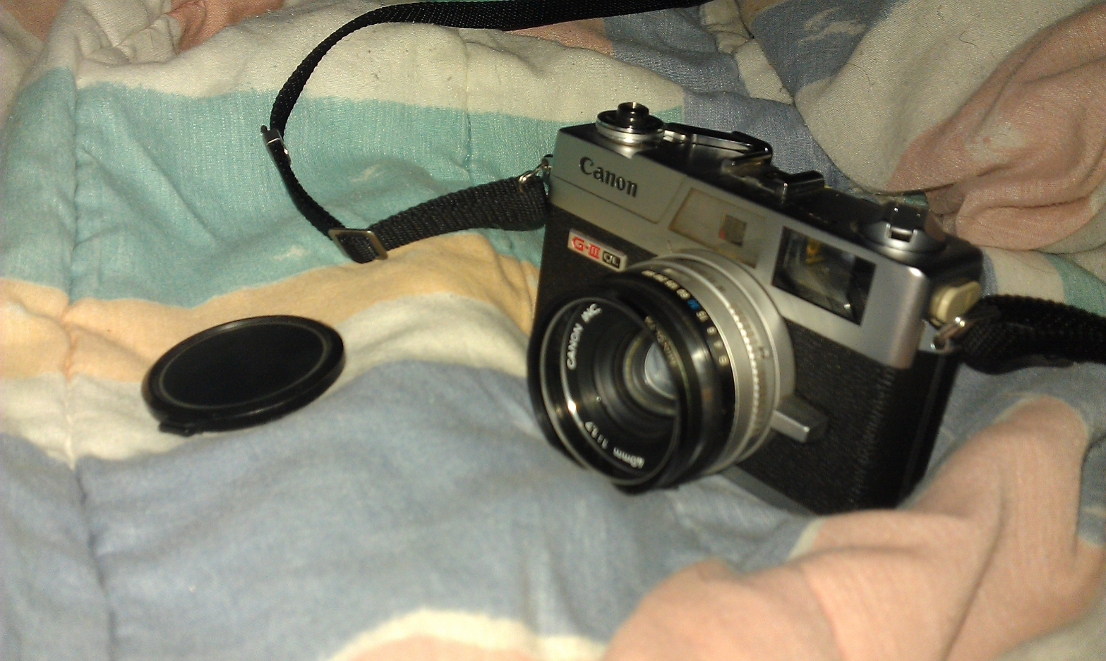

I've been wanting one of these since I was a kid, and while I was picking up my enlarger and some accessories for it, I ran across two of these cameras in Dave's cabinet. I asked him if he had any plans for them, and he said no, that the shutters weren't working in either of 'em. Did I want one for, say, $25?
Uhmmmmmm..... SURE! They're both nice, but the one I picked looks like it just came out of the box, really minty. I took it home and looked at the shutter. Nope, nothing happens. Then I accidentally tapped the lens barrel on my Kowa case putting it down and hear a click. Eh?
I checked it again. Now the shutter is working, but it's sluggish to open. Ah, congealed oil? So... it seems I have a very fixable camera in my hands, and have to decide whether a standard pro CLA will take care of the problem, maybe something I can do myself, or will I need to find a specialist to fix it for me...
Also, she needs a battery...

I never put a battery in my GIII. It's one of my most-used cameras.
Is your lens loose? My lens wobbles slightly like it's loose from the camera body, but I have never figured out how to tighten it.

It is a leaf shutter, it will need to be cleaned. I saw the KEH listed on for almost $300 and stated it has a rare element lens. I have one for years, a friend gave to me when he bought a 35mm zoom point and shoot in the 80s. Very sharp, easy to use. Shot of free lance travel in the 80 and 90s.

I've had a couple of these cameras over the years, they are terrific. I would give it to a shop to do, they are worth it. Lens is excellent.

Yes, it's due for a cleaning, old lube is the villain.

I have two. The lenses both wobble. I have heard that if you tighten them, the focus/aperture/shutter dials get stiff. It doesn't bother me and it doesn't seem to have gotten any worse over the years they've been in existence. It's a fun camera. An SR44 battery will get you going. If you're picky, there's a pot you can adjust under the top cover to tweak the meter to compensate for the voltage difference between Silver oxide and Mercury cells. I shot a few rolls and think I'll leave it as is.
I worked on one of them. The front lens is easy-peasy to get off, used a selection of tools I made myself from some cheap General brand calipers, dividers and long nose pliers with a Dremel tool to shape the tips. Ronsonol lighter fluid as a solvent loosens up the shutter just fine. Then I noticed that the coating on the front element was scratched and the rear element had tendrils of fungus. It still takes good pictures, but I found another that had a perfect lens, and those photos are even better! But they are pretty easy to disassemble from the instructions located here: http://www.rangefinderforum.com/forums/showthread.php?t=90468
Thanks for the tip. I have the battery issue covered, and a sticky shutter is my remaining problem. If I can't get an affordable fix at a shop, I'll have no choice but to go in myself. I'll look around for a clunker camera to practice on first, though.
