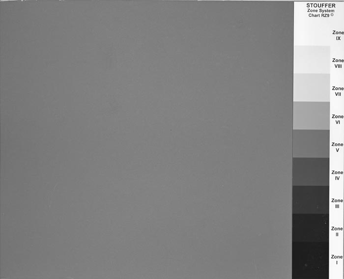

I have and use densitometers but a habit I've found handy that is simple and intuitive is to use a Kodak gray card with a Stouffer RZ9 strip glued to the edge as a target. On roll films, I shoot a frame with this target and interpret the tone separations. It is very easy to decide if I've under/overdeveloped and/or under/overexposed from a quick glance at the negative. Partly from having the densitometers to confirm what I'm looking at I suppose but it is quite easy to develop an eye for what's happening by looking at the low and high zones on this arrangement.
