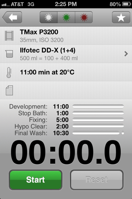

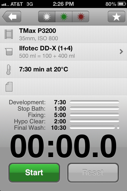

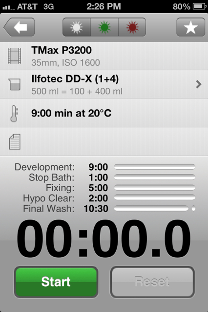

This is what I get for massive dev chart says at 6400, 3200, 1600, and 800... All ok DD-X
I've found the times fairly accurate for development
If that gives any indication?
~Stone
The Noteworthy Ones - Mamiya: 7 II, RZ67 Pro II / Canon: 1V, AE-1 / Kodak: No 1 Pocket Autographic, No 1A Pocket Autographic

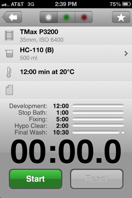

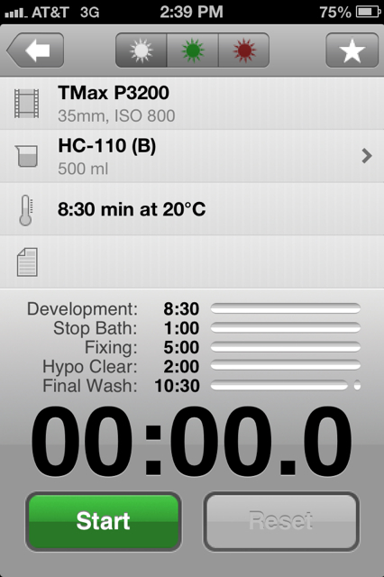

Also for comparison the HC times with P3200
~Stone
