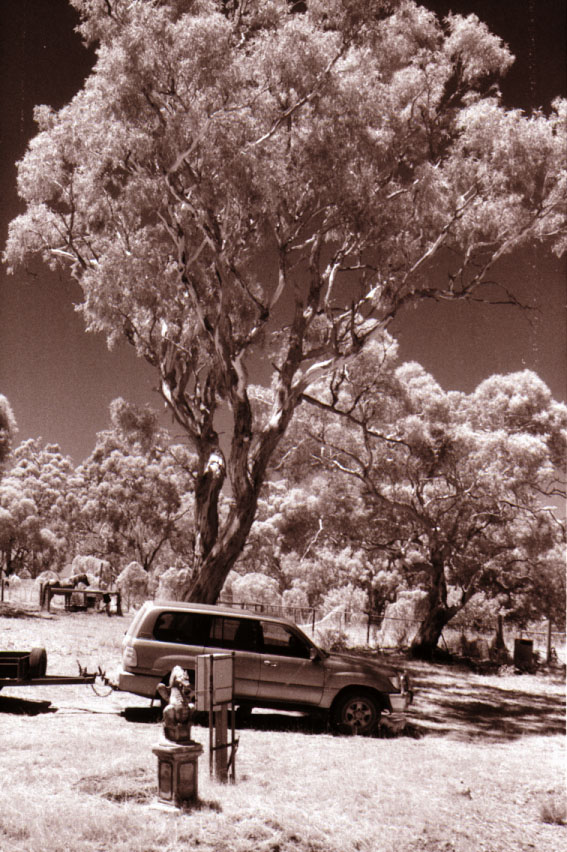

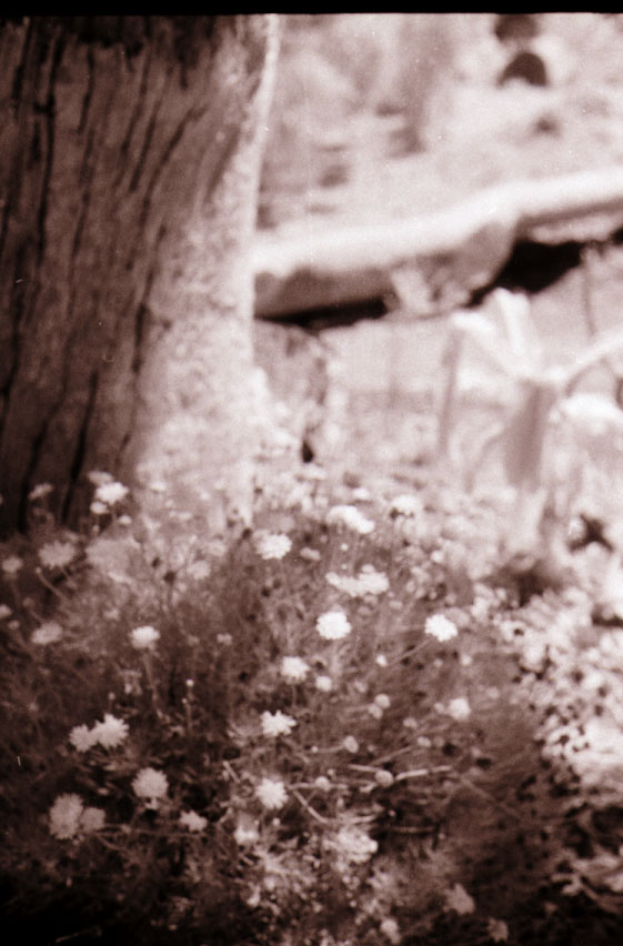

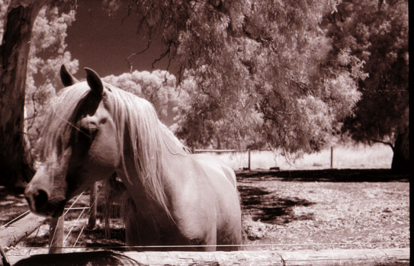

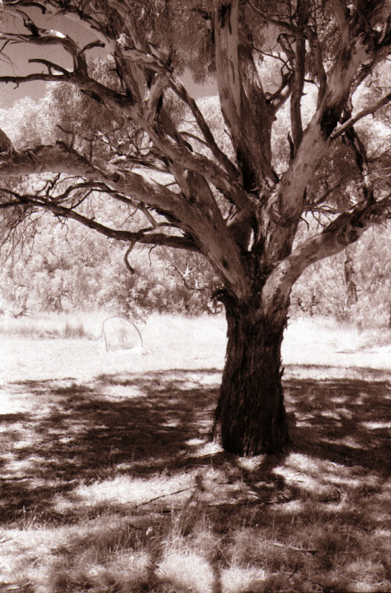

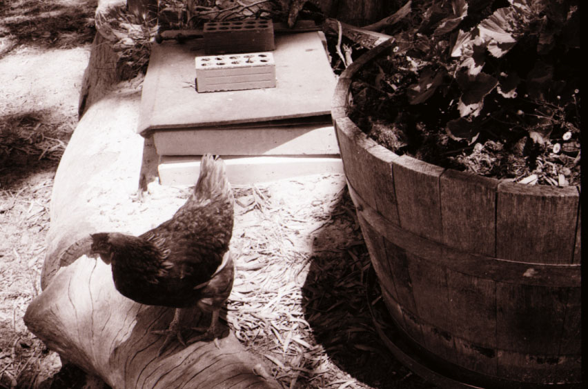

Dried and scanned - ignore any of the splotchy marks, it seems some minerals in my wash water is intent on sticking to the back of the film. I'll rewash on the weekend when I get some distilled water.
First picture with the filter in place, second without. Highlights are rather blown out in the second, but my scanner has that habit - we'll see how it prints.
The third, I adjusted to the IR mark on my lens, and it's out of focus. I dont mind, I like it.
The fourth and fifth show the IR effects a lot better, both focused at good ol' infinity.
It seems the TTL meter was correct in it's suggestion. I'll work on the focus in the second roll, but it's a lot of fun. Glad I got five rolls.
