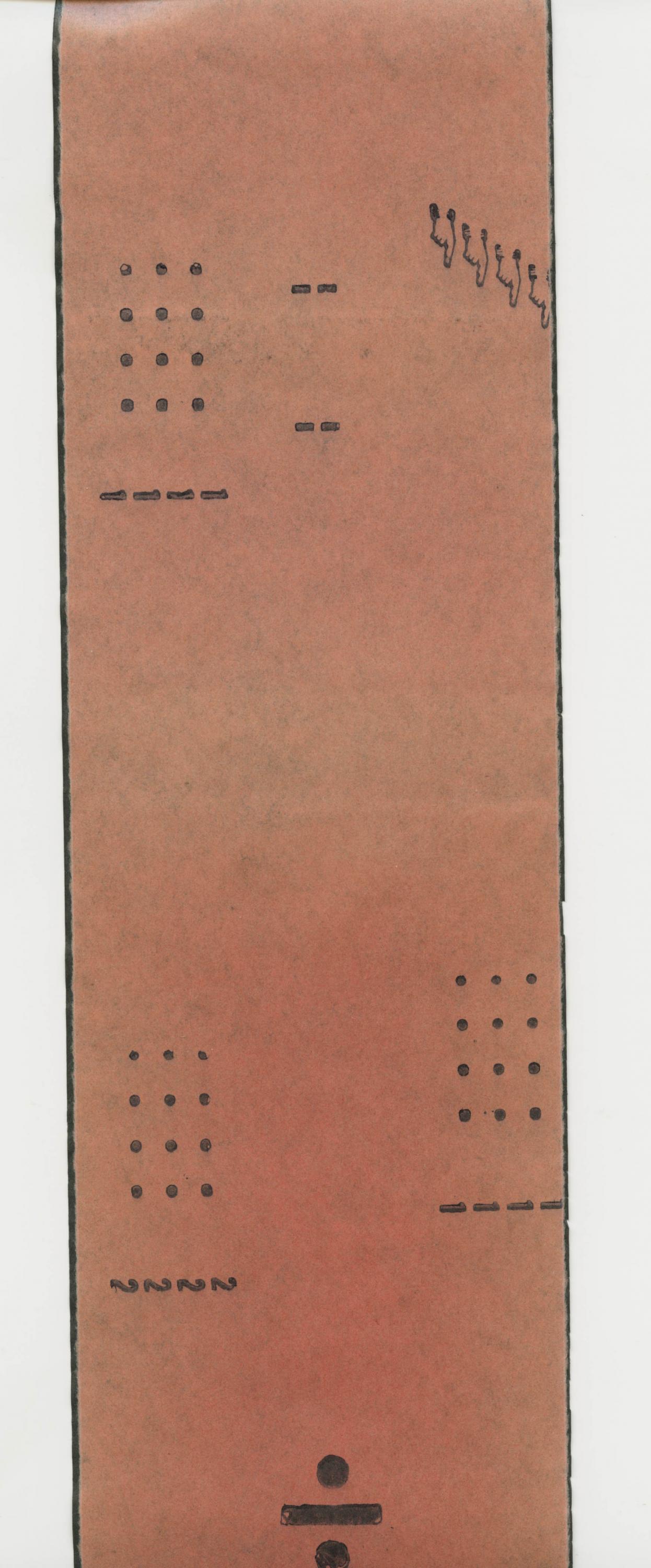

Does anyone have the specification for the markings on 122 backing paper?
I know I could copy off of an old backing paper... If only I had one.
The distance between numbers - centre of one number to centre of next number is 5 3/4 inches the stagger between top number and same bottom number is 1/2 inch. I have attached a scan so you can see what I mean.
