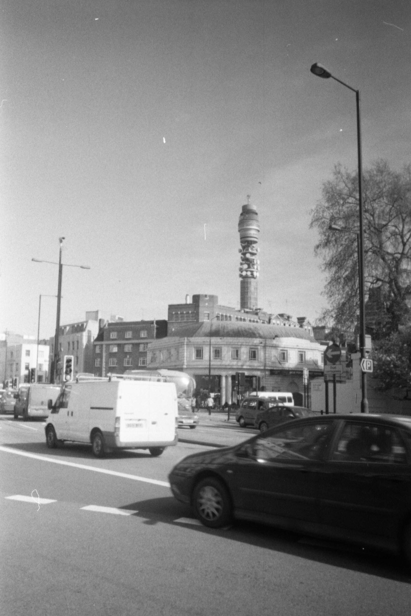

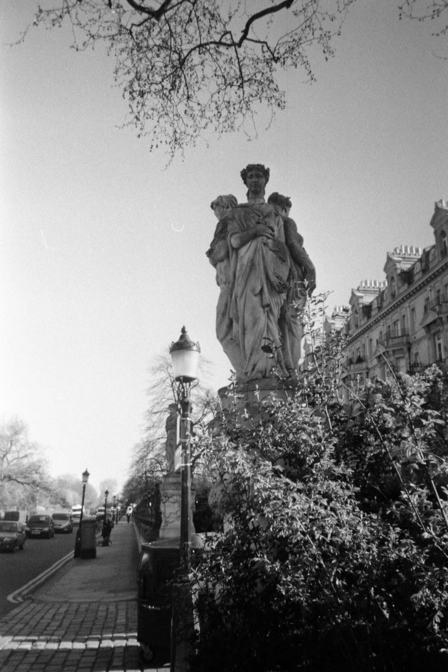

Well just tried this with a colour C41 I got in a £1 disposable camera from poundland. The film was marked as Kodak 200, but I'm not necessarily convinced about that. Might have been a recycled canister, as there are no edge markings on there. (Is this a characteristic of disposable camera films?)
From first looks, good density negatives, the result not unlike the sort of thing you'd get with Kodak BW400CN. The negs are still somewhat milky, but thats because they haven't fully dried yet. When they're ready for the scanner, I'll post a few here
(R09 1+100, in water, agitate 1 minute, stand for an hour 20 Deg C, fix for 5 minutes)
This could be quite an interesting exercise...

And from the plate of the scanner.....
Raw, No corrections, only editing was to shrink to 50% size so I could upload
Oh and yes, I really need to wipe the dust off the scanner as well!
