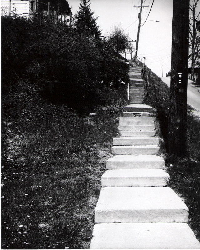

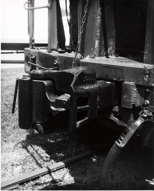

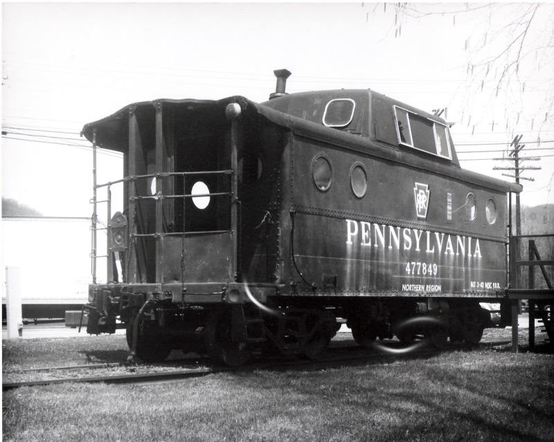

I was sitting around and a bit bored, so I grabed what I thought was a roll of HP-5+ outta the fridge and loaded the Mamiya 6. I took a nice long walk around town and shot a few frames, then finished last evening on a walk with my daughter. I get home and go to pull the roll from the camera, when I realize it was a roll of XP2 super. Aw nutz... Anyway, since I don't do c-41 at home, I decided to spool it up and soup it, some quick checks showed D-76 for a total of 15 mins at 72f, so I have D-76 but I decided on PMK Pyro, and went for 15 mins at 72f. In retrospect, and close examination of the slightly thin negs, I probably should have souped for 30 mins, but they are what they are.
I printed these test enlargements on some Kodabrome G5 I had on a shelf and forgot about, not too bad. They could definitely use tweaking, but all in all, I'm happy with the results.

Rick-I really like the last shot of the stairs. It's almost a little disorienting, your eyes follow the stairs and then hit this dizzy spot about half way up where the stairs tilt.
