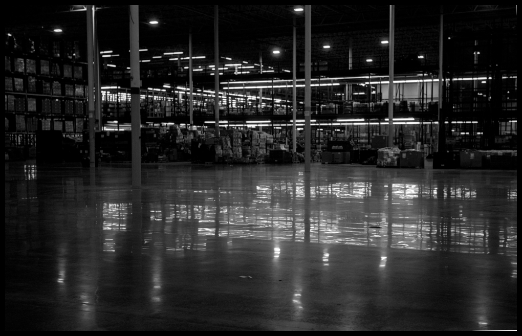

I don't find any noticeable increase in grain with bleach bypass. I first did that with Kodak T400CN, and didn't see any additional grain there, either. I suppose you might see that if you printed XP2 Super with Grade 5, but I've seen little grain when I've processed it in B&W chemistry,either -- to my eye it's finer than T-Max 400 done that way, so with bleach bypass, you're adding that fine grain to the nearly grainless dye image.
https://www.photrio.com/forum/media/early-before-shift.63670/full?d=1602454161
