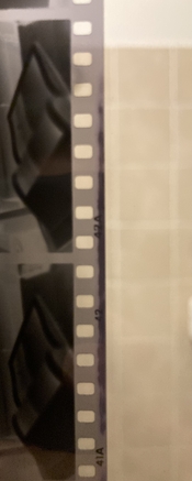

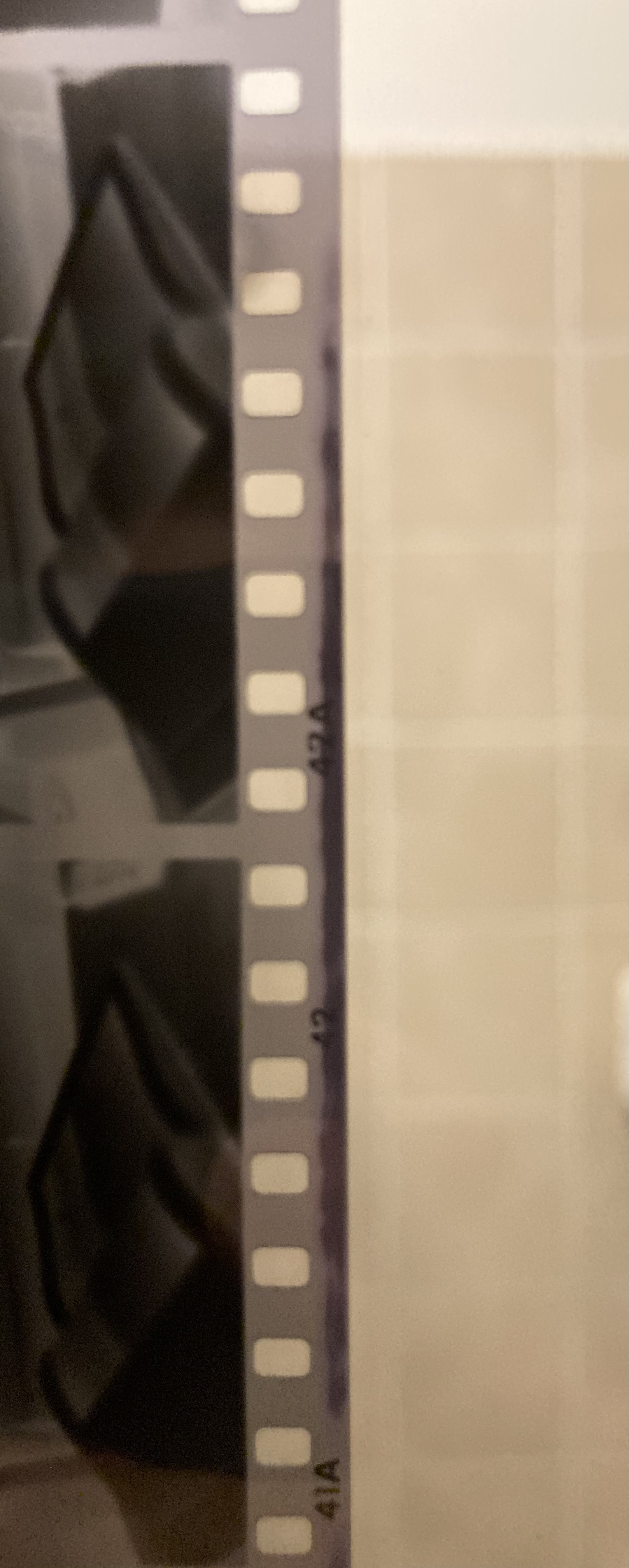

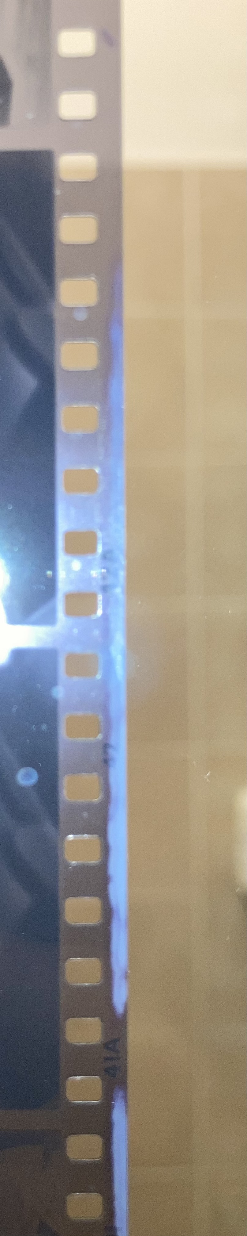

I indeed performed a test, in particular I developed two of the closest/most unprotected film roll relative to the “disaster” (none was actually touched by the liquid luckily); if I had to be extremely pedantic I’d call the result “inconclusive” since one of the two rolls showed weak/peeling emulsion on the sides (roll coming from same 100ft bulk, same bulk loader, shot on the same camera a month apart, loaded in my usual tank); as long as I can remember I never experienced such defect (at least not this year, I checked the recently developed negative archive, I’ll look in the older ones). The other one showed no evident issues (at least to my eyes, I’ll either scan or contact print both).
But given the experienced suggestions of the fellows above I’d rather be more optimistic and say that the emulsion peeling might be connected to an unrelated event; I’ll perform some other developing a and shoot some of the film stored and keep you posted.
In the meantime thanks again to all for the knowledge shared, and of course now I’ve leaned my lesson… to keep chemistry and lightsensitive material apart! Next time I might not be so lucky…
