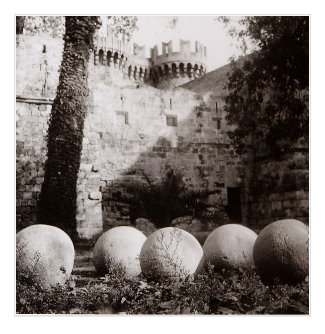

I just finish printing with Fomatone (paper) and Ilford Wormtone (developer).
I really like it.
But it has a tine green tonality on it. I dont' know yet if I like it. I don't rate it certanly but I am not 100% confortable. Maybe it is because I am not used to it yet. But I like the worm look.
Maybe I can use something to "stain", like tee or coffee, to make its colour more bown and less green?
PS: not selenium because I decide to stop use it.
Ilford Warmtone can be pretty cool if used with a cold toned developer (like LDP straight) or warm to green with a warmer tone/more dilute developer. I really don't like it straight out of dilute developer. Even a brief selenium tone helps....and I understand why you don't like selenium. The nice thing about selenium is that it tones the shadows first allowing you to sepia tone the highlights. If you just sepia tone, it gets really brown if you tone all the way down the shadows. I wish I had an answer for you that didn't include selenium. One other alternative to consider is to just use a neutral toned paper, bleach it a little, and sepia tone. That will give you black shadows and warm highlights.
I've used Fomatone Classic MG 131 with Ilford ID-78 developer which is essentially the earlier version of Ilford Warmtone developer.
Here's an example, selenium toned, neutral grey scale as a comparison:
As with most warmtone papers there's initially a slight greenish look and the best way to neutralise this is by selenium toning. I know the OP wants to be Eco friendly and one advantage of Selenium toning is you keep re-using it and just top your working solution up with fresh toner every so often so there's little to no disposal issues.

I love that result, Ian. How strong do you mix the selenium? How long at what temperature? Would a comparable treatment give similar results with Ilford WTFB you think?
I like the results I get with MGWT and Harman Warmtone developer + very dilute brown toner, but the toning can be difficult to control. It also yellows the borders (and highlights, of course.) That can look fine in the highlights as long as your overmat covers the borders.
Yes the results with MGWT are fairly similar except the paper base is whiter than the Foma. The Foma gives a slightly more olive brown but the difference is slight.
My Selenium toner must be 20 years old and I just top it up every so often with fresh toner, occasionally I filter or decant it. You shouldn't get any yellowing of the paper, that's usually an indication of residual silver left in the paper after fixing. Two bath fixing should prevent this. It may also be you're over-washing and removing the optical brighteners, as well as that some mat board is too white and doesn't work as well with warm tone prints.
I use KRST at approx 1 to 20, I top it up with stronger probably about 1 to 5 as it gets exhausted. I've found it's better to do the toning in daylight as it's harder to see the colour shift in artificial light, at the beginning of a toning session I'm careful particularly with the first prints to watch the colour change and the time it's taking as that gives me a basic indication for later prints.
As you noted you either need to use the developer more dilute or shorten the dev time, the toner increases the Dmax, over development kills the warmth.
