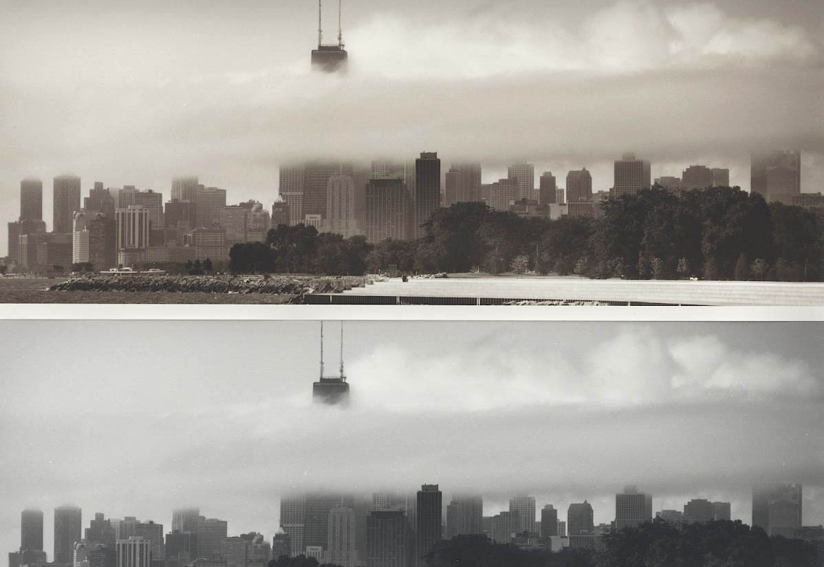

Semi-Matte Example
Dear zrisso,
Attached is a quick scan of the semi-matte surface developed in Dektol. The top image was toned using Kodak brown toner. I find this paper to take a much truer brown when using this toner than others.
Neal Wydra
Hmm... I might just have to lightly tone it. The top looks somewhat like what I want, but I'd want it quite a bit less toned.
Since the Kentmere brand isn't made anymore, I might have to settle for toning.
Be aware that that example is from Ilford Warmtone semi-matte. If the semi-matte reacts anything like the glossy variant of Ilford Warmtone, than it will bleach and tone quickly. You may wish to use a diluted bleach for better control...
The still available glossy Kentmere Fineprint papers tone also very nicely and quickly. In fact, I like the tone a bit better, especially when fully bleached and toned, as Ilford Warmtone glossy has a tendency to go an ugly orange in that case, which the Kentmere papers don't. But a recent gallery post by another APUG member showed better results by pre-sulfiding the Ilford Warmtone paper by dipping it in thiourea first, before fully bleaching, resulting in a more pleasant dark reddish tone instead of orange, something I must try out once.
Anyway, not much relevant, since you want to tone very lightly... :wink:
