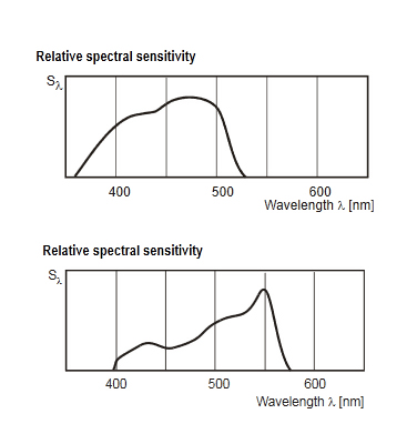

Just to show the differences:
These are the spectral sensitivities of Fomaspeed Graded paper (top) and Fomaspeed Variant III a variable contrast paper (bottom). So quite a difference.

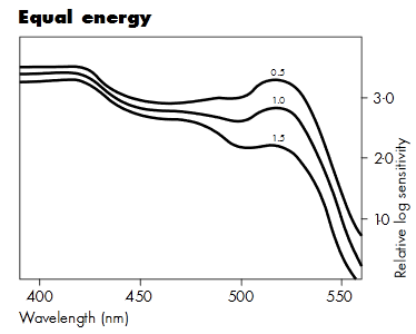

Ilford's own chart for Multigrade IV (below0 isn't directly comparable Their chart for Ilfospeed RC DeLuxe is similar to the graded Fomaspeed.
