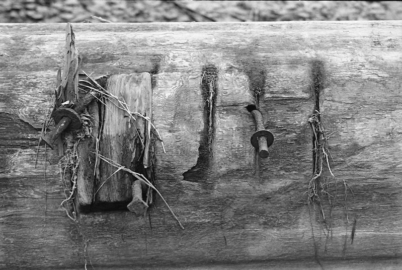

TMY at an EI of 250 (due to contrast) in X-Tol is eminently hand-holdable.
A self portrait of sorts as an example:

I meter and shoot TMY-2 at speeds between 200 and 800, depending on subject.
I develop TMY-2 normally in most cases. If the lighting conditions warrant it, I sometimes increase development, but rarely decrease development. It tends to perform really well in replenished X-Tol, but it also performed really well with slightly less speed in replenished HC-110 E.
The car shot I posted was metered at 250 because of all the shadowed areas that I wanted to render "generously".
This is from 35mm TMY-2 metered at 400 and developed slightly longer (39 instead of 38 on the Kodak Darkroom dataguide developing computer) in X-Tol R:
