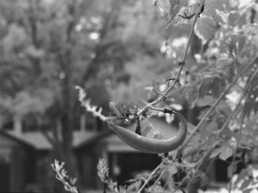

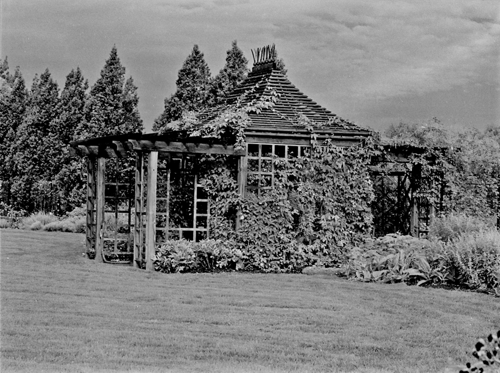

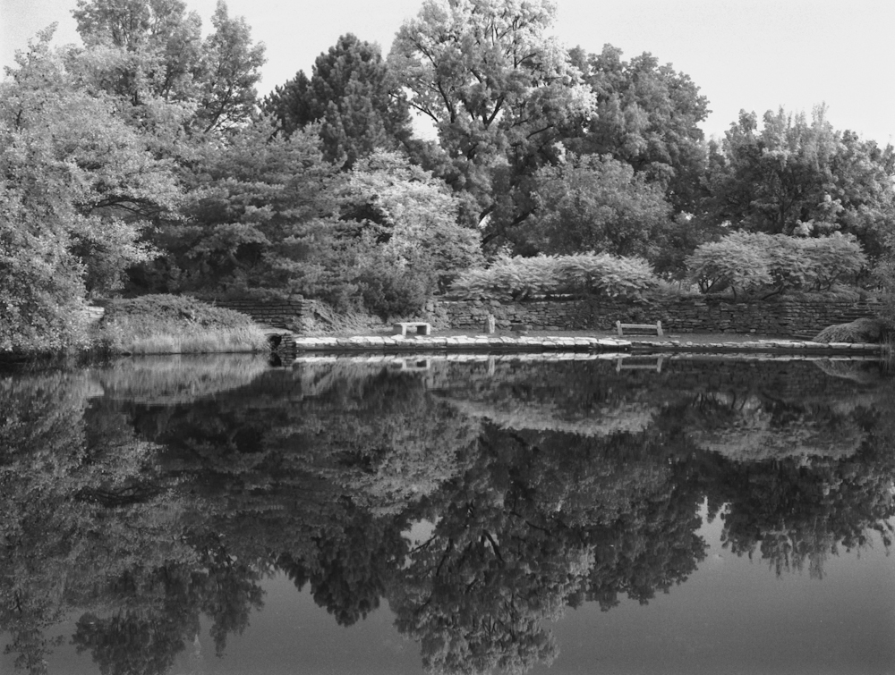

Here are scans of my first attempt. These are with the IR720 filter and scanned with my cheapO HP G4050. They do not seem to have a lot of IR Look although I can see a little.
Any suggestions to help improve this? I know it was an overcast day, not a one of these images were done in sunny 16 conditions. Best exposures with this filter were 3.5 to 4 stops down from metered exposures.
The first one of the pond seems to be the best of all, but all are lacking a Good IR experience.
Lee

Lee, I like the IR effect you got in your first 2 shots, not too much IR but still just a hint of it. I would like to see the results taken on a bright sunny day.
I think your filter is cutting off light below 720 nm and SFX is sensitive up to 740 nm. Maybe that's the problem?
Thanks Tex.
I too look for a sunny day to try again. I have one more roll here at the house. Looks like I can count on my hand held meter for box speed minus 3.5 to 4 stops for the filter. Just add sun.
Lee
