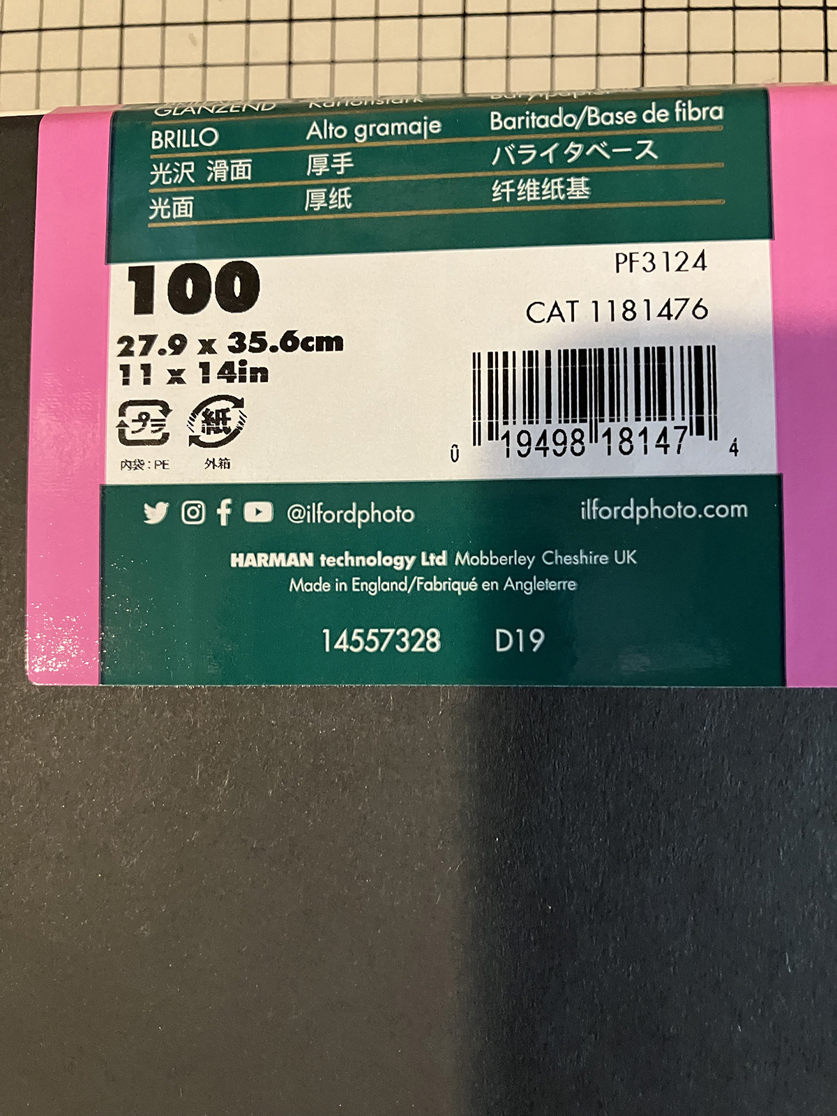

Well, it definitely says Harman Technology on the label, but the design is different from the current one. Here is the old paper label:
Here is ta lebel from some paper I bought a few months ago:

How old can it be? it has the ilford instagram account on it.
According to Instagram, Ilford joined in 2016.

Sort of. The old paper is 20x24. I guess I could cut a sheet down to 8x10 for comparison purposes, or at least to get a ballpark idea of how it performs.
