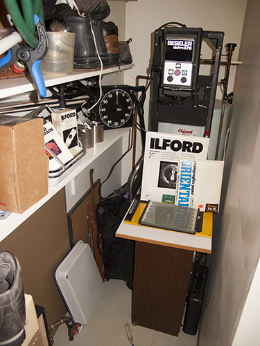

(I just found, to make 8oz i.e. working volumes, 6X plastic liquid packs of Technidol. What was this fellow shooting with all this...??!! this stuff is for Tech Pan and LPD4 films. I used to work a copy darkroom (graphics, draughting, copy) in the early 90's but I've forgotten most of what I learned and worked with.)
I also found five packs of D76 powder. stained packaging but the powder is 'still' powder.

If the D76 packets are still sealed then they should be OK to use. I'd make up one pack and initially try it on a film where the first 8 negs are unimportant. In the complete darkness cut the first 12 inches of film out of the camera and respool the remainder onto the take-up spool Develop the film cut out of the camera If the negs are fine then the D76 is good to go
