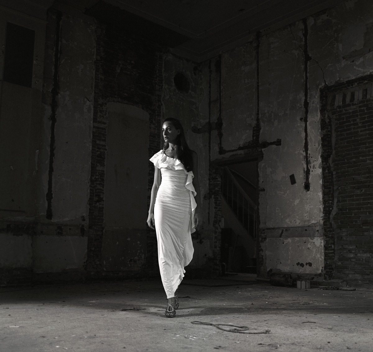

@StoneNYC I've attached the example. It's hard to show the negatives as they are in a digital image, so I hope it is of any value:wink:
Is PanF a higher contrast film by nature? For instance if Kodak 125PX has 7 zones, does PanF have 6 a bit sooner. Maybe only in Rodinal? Than I might indeed under develop and need to shoot for less contrast. It might be a small diference, I've used the 125PX so much that it is hard to properly judge a film that is very different.
Is it true that Rodinal in high concentrations (1+25) creates higher contrast negatives even if they are slightly underdeveloped? I'll put it to the test but maybe someone has experience with this.
I a very nice pm I was told ASA 50 films might have a slightly higher contrast anyway.
So the solutions seems rating PanF at ASA 25 to get a denser negative and develop as I did. (If developing a bit longer in rodinal 1+50 does the trick, I'll let you know)

Also OP unless I'm blind, I can't find any examples, can you show what you mean?
Or direct us to an image like I have?
~Stone
Mamiya: 7 II, RZ67 Pro II / Canon: 1V, AE-1, 5DmkII / Kodak: No 1 Pocket Autographic, No 1A Pocket Autographic | Sent w/ iPhone using Tapatalk
In the attached image above you can see the lack of detail in the highlights, this was no problem with Kodak 125PX. But you guys already gave me some things I should try that might get it right next time, thanks!

OP you must do whatever you feel is appropriate if the neg and subsequent print(NB this is the real test of the neg) isn't what you want it to be but the scan if it's a true representation of the neg does show highlight detail in my opinion. I am basing this on the white dress where except for direct sunlight there appears to be all the highlight detail I'd expect in the light conditions. The two area where there is no detail is the hip area and the forehead but both areas have direct sun on them and become close to specular highlights.
The shadow detail in such contrasty light appears pretty good to me as well
I would like to see an example on a different film.
To me it just looks like you don't have enough light in the right spots but I wouldn't blame the film, I would say you should have given a SLIGHT diffusion, that the light is hitting her face "too fast" or the lamp is too close. I've never had an issue like that one, I see what you mean but I would blame the lighting first, it's not terrible but I feel like her skin is super dark and doesn't match what her complexion should be. This happens to me a a combination of if the light source is too close to the subject and the WS is too high. What brand of head/pack do you use? And what reflector did you have on?
