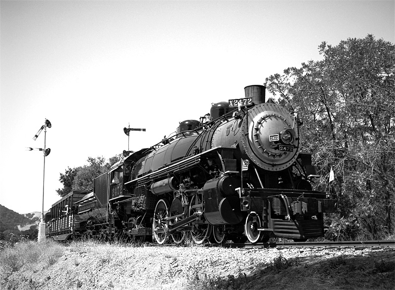

You won't be able to see much in a compressed digital file, but this Pan F+ neg prints very nicely, with good black-on-black detail.
