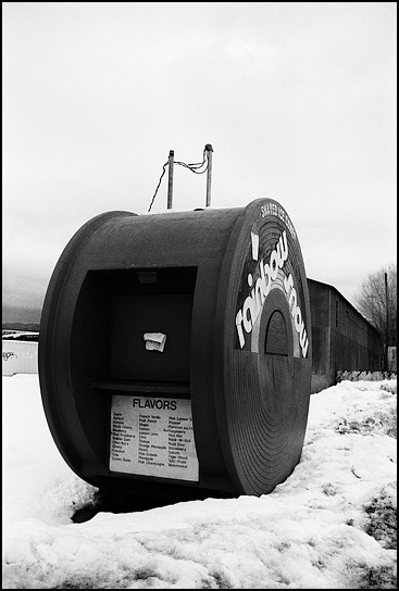

DDX is similar to Kodak Tmax Developer, being a good general purpose developer and an excellent developer for pushing high speed films. There are better developers for slow films like Pan-F. Rodinal gives beautiful tonality and sharpness with Pan-F. Even D-76 works better than DDX for Pan-F, in my opinion, but Rodinal 1+50 is great.
This is 35mm Pan-F developed in Rodinal 1+50.
