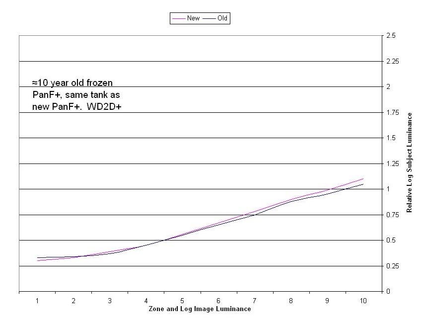

I think I posted this once before but I tested some long-stored PanF+ vs new and found only the slightest difference (imperceptible to my eyes). I was doing some initial sorting out runs with WD2D+ and thought I'd solve 2 things at once. Here's an old graph of the densities (likely from about 2005):
That lines up with what I found as well. I even tested some frozen Pan-F (non +). That compared very well to the newer version. I honestly had a hard time seeing what the "+" added, it's always been an excellent film for me.
