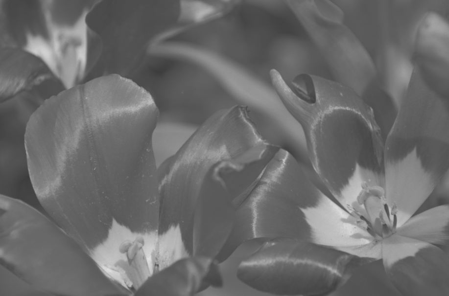

Here are the results from my 1st attempt using this combination.
I used a Patterson 2 reel tank (two rolls were processed together). I used the following ratio:
Rodinal 1+100 for 15 mins, agitation/inversion @ every 5th minute.
1000ml water + 10ml Rodinal concentration.
Start = 3 inversion
5th Minute = 3 inversion
10th Minute = 3 inversion
15th Minute - pour out.
Stop bath 20 seconds
One quick water wash
Fixer 5 mins
5 Minute Wash - agitation constant for 1 minute cycles renewing water after every minute (Photo Flo added to last minute wash cycle).
A couple of things to note here. I don't have much experience processing B&W (as you could probably guess from the included image). I mixed up 1000mL water and 10mL Rodinal. Of course I only poured approx 550mL into the tank - I am not sure how much developer solution I should be pouring in the tank (should I change my ratio?). Also, do you start the timer while pouring the developer solution into the tank or not? I am not sure if this will make a difference.
The image is salvageable with some image editing. However, it would be better to work with a cleaner negative.
Any pointers/suggestions would be greatly appreciated.

I don't know where you came up with this agitation scheme but it is no good, especially with a scene of normal or low contrast. The result is a muddy, uneven, flat negative with poor shadow contrast. Go back to what I posted and refer to Ilford's instructions. Particularly if you're not experienced, start with a standard procedure.
I used the agitation advice from an earlier post in this thread.
Next time I'll just use the Massive Dev chart since Ilford doesn't have instructions for ei25.

Here's the results of developing Pan F+ using the Massive Development chart. Although the negatives are somewhat improved, it seems there is a cast on the negative. pan F + using MDC times.JPG

Are these scans of the negative or of a print? Either way, these scans seem off (or the print if the print looks the same way). It looks like you have a fair amount of detail here but the contrast is way off.

I agree with Brian. There is detail everywhere so the film exposure is adequate, but the contrast is pretty low. What grade paper did you end up printing on? If it is higher than grade 3, then try developing about 10-20% more and that will increase the contrast. If it is a neg sacn, you have all the information there so you should be able to make the proper adjustments in Photoshop. Back when I used to scan negs, I found that the images out of the scanner were pretty much always flat, the they printed nicely.
I use Rodinal for everything I do now. I find that Digital Truth numbers for 1:50 are pretty much spot on to get grade 2 (condenser) or 3 (diffusion) for the way I print.
