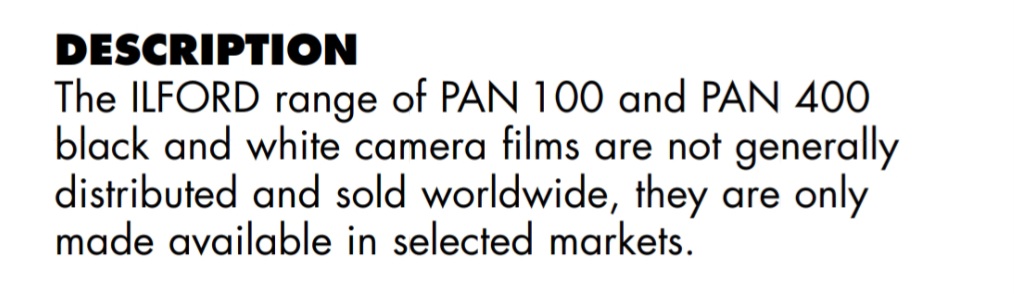

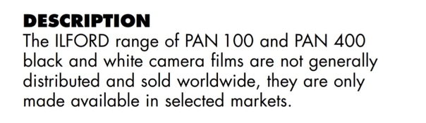

The 2002 datasheet even says that the "Ilford Pan" films were "not generally distributed/sold worldwide, and made for select markets. I uploaded the 2002 datasheet incase you wanted it.
