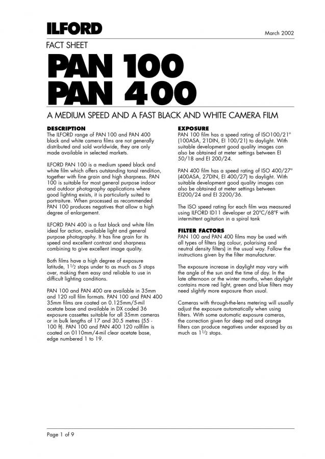

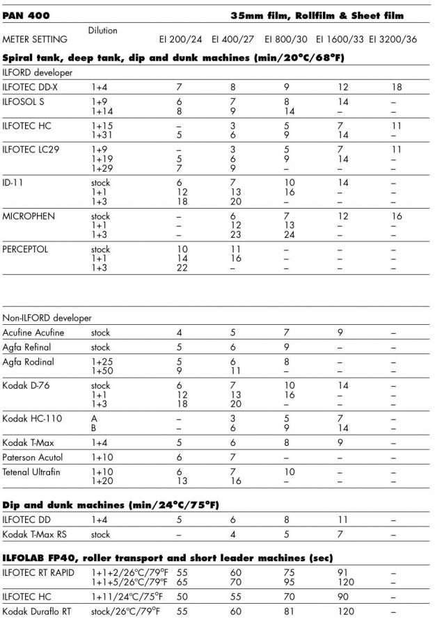

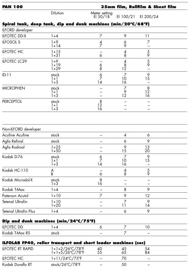

I attached 3 pages of the Ilford publication for these films.
Aron
