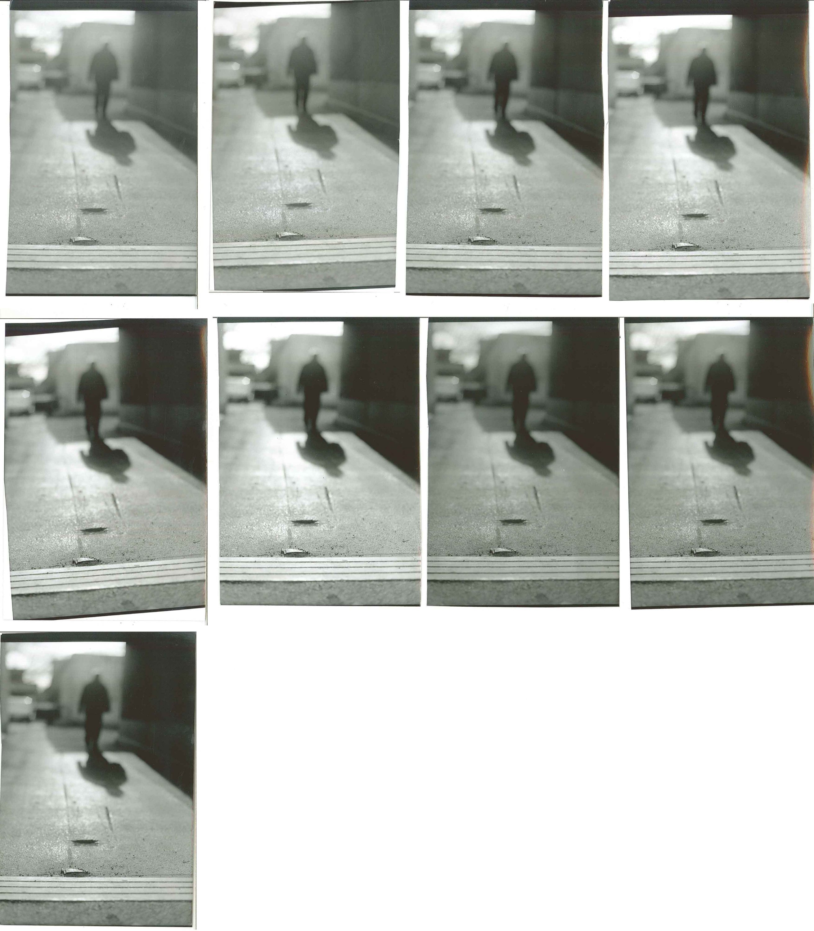

Hello!
I bought second hend Ilford filter set and on instructions which was inside of box write: "MULTIGRADE filters are very easy to use: no complicated calculations are needed when changing from one filter to another. The exposure time for filters 00–31/2 is the same; that for filters 4–5 is double."
I don't know how and why, but I don't have a good results with this instructions. I made a several tests, allways used only Ilford products (Multigrade developer, stop bath, fixier - all at 20C degree, RC paper).
I have the same exposure time for all filters (6sec at f11) and the contrast increased for 0-3 1/2 and than fall. Blacks and shadows are good but highlighs totally go to grey. I supose that I need to have a brighter highlights with filter 4-5 than 3 1/2. The highes contrast I recived with filter 3 1/2. For me, photos with 4-5 filters are like combination of split printing with filters 0 and 3 1/2 but with more 0.
Examples: 1. raw - Gr: 0, 1, 2, 2 1/2
2. raw - Gr: 3, 3 1/2, 4, 4 1/2
3. raw - Gr: 5
Does anybody have expirance with results like me? Maybe I have a problem with filters or maybe I made some mistake which I don't recognized yet.
Please help me with sugestions.
Thanks

The idea of keeping exposure times constant while changing contrast is a myth;it doesn't work; it can't work;exposure time controls highlight density;filtration controls shadow density;there is no way to change filtration and keep exposure constant;whenever the filtration is changed,exposure has to be changed to keep highlights constant;Ilford's instructions are misleading about that.the workflow is:
1.find exp time to get desired highlight density.
2.find filtration to get desired shadow density.
3.adjust exposure to maintain highlight density from 1(tooted but necessary)
Nevertheless,a test sequence can help to determine how to adjust highlight exposure for any contrast change,which will help to maintain constant print densities but it is not as easy as Alford wants us to believe.

You beat me to it Ralph, I concur. The examples do show changing shadow density, but without adjusting time also, it's pointless. I've even found that lowering contrast sometimes requires extra time, not less time to obtain the proper exposure.

As others have said, if your paper and chemicals are fresh then it is some or all of your filters that have faded. Are these filters for a filter drawer or under the lens filters? The filters for both are exactly the same except that under-the-lens filters are in plastic holders. If you have a filter drawer then get a new set from Ilford. If you have under-the-lens filters then get the same "open" filters from Ilford that fit into a filter drawer and split the plastic holder carefully with a sharp, narrow-bladed knife, remove the old filter, hold the old filter on top of the new filter and cut round it accurately with an ordinary scissors, place the new filter in the holder and press it shut with your fingers.

Before a few days I recived new filters. I didn't have a good filters. My old filters are faded and they are totally different colors than are new.
Now I'm in new world of printing :smile:.
