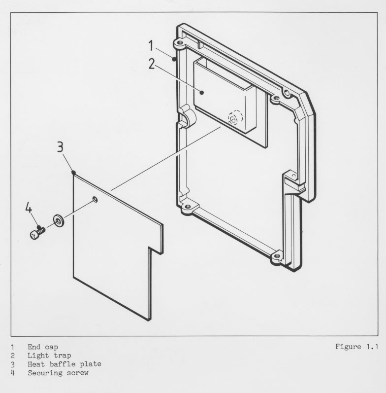

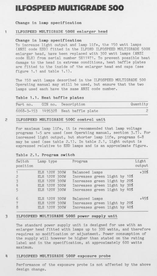

1) as far as I know the heat filters are two pieces per side.
3)See attached re 300w..

Having done this a couple of times... Heat filters are two parts/ side - Odyssey should have them and the dichroic filters. Make sure that the filter frames are not buckled from heat before you attempt the filter replacement - and that you have a way to catch the filters safely when they fall out of their tracks during disassembly/ reassembly attempts. The heat filters will happily smash the dichroic given a chance...
ELH bulbs very quickly became the standard in the MG500 heads - the main issue is that there were several slight variations (some have Y & M filters) in the heads - and they were made by two different sub contractors, so the instructions found online may not reflect all heads...
