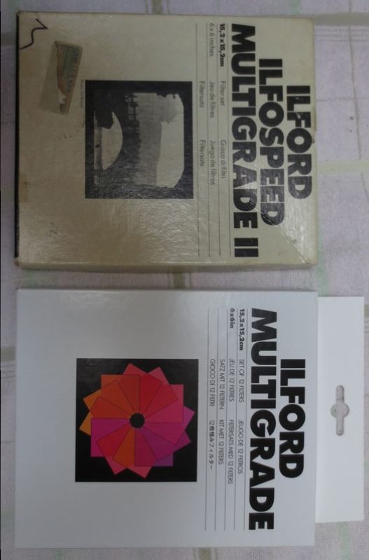

Hello Folks, once again I seek the wisdom of the net. The issue is Ilford Multigrade filters. I have had a set for a long time, and on the box is “Ilford Multigrade II”. They have been there for a long time because I was primarily a Kodak paper user. Now I use Ilford fiber and Ilford and Oriental Seagull RC paper. And with all the papers, probably 95% of my printing was done with grades 2 through 3 ½. But I was printing with Ilford recently and got the impression that printing with the 4 and 4 ½ filters actually gave lower contrast than printing with the 3 ½ filter. And I printed something with some old Kodak paper that I had in the freezer; I printed with a Kodak 4 ½ filter, and it was way higher contrast. Also, with higher number Ilford filters, I need less exposure. I either close down a stop, or I have to cut exposure time by about half. This is the opposite of the Kodak filters; more exposure is needed with higher number filters.
So what’s up with the apparent low contrast with the Ilford higher number filters? I notice this on both fiber and RC. Are my filters out of date; that is, is there a newer version around? I checked the B&H web site, and there is no designation on the filters. Any ideas out there?

If i remember correctly, the Multigrade II filters had to be used with the Multigrade II paper, which was replaced with the Multigrade III and later IV paper some thirty years ago. It came with some kind of calculator, because you had to change the exposure time of the paper when changing grades. With the introduction of the Multigrade III paper, a new filterset was introduced where you only had to change the exposure time when switching grades between 3.5 and 4. A second reason to replace the old set is that filters tend to bleach, especially the higher grades. And as your current set should be at least 30 years old...

Dear Mark, See Huub's reply, its spot on :
So based on the above and Simon Galley's response MGII filters are useless with modern(MGIII and IV) paper as they need a calculator but this in turn became redundant when MGIII and IV paper came along so even unused MGII filters with or without a calculator are waste bin material?
This surprises me. I had never seen any statement to this effect being made before. Maybe and hopefully I have misunderstood Huub's statement and in fact MGII filters can be used but a calculator is now unnecessary as changes to the paper make it redundant?

I have found a site which in the past I have found to be reliable. it is called Ilford memorabilia and covers the history of MG paper and filters. If it is to be believed then the need for a calculator was before MGII filters.
The essential differences between MGII and MGIV filters appear to be two-fold:
1. The MGIV set is 12 filters and includes an 00 grade whereas the MGII is 11 filters with no 00 grade
2. Both work fine with current MGIV paper but the older MGII filters have the same exposure for grades 0 to 3.5 with twice the exposure for grades 4 and 5 whereas the MGIV filters have the same exposure for grades 0- 3 and twice the exposure for grades 3.5 to 5
In another search of APUG threads I found a reference to MGII filters by an APUGer who made no mention of his MGII filters "not working" with current MGIV paper
So it appears that unless Huub was referring to the set of filters before MGII filters, then MGII filters operate OK with MGIV paper with a slight variation on which grade onward requires the twice exposure routine.
All of this of course assumes that I read Huub's post correctly. He might not have been saying that MGII filters need a calculator and neither might Simon Galley. It was simply me that was misunderstanding their posts.

I can assure you I am significantly older than MULTIGRADE II, but thankfully not MULTIGRADE I
( Circa 1940 ).
Whilst the 'matching' of the grade speeds with MULTIGRADE filters has changed the much bigger issue is with the age of 'these' MGII filters themselves, they FADE, slowy, but they FADE and the more they are used the more they degrade by 'WFS' ( Wet finger syndrome ) and 'LOTBS' ( left on the bench syndrome, instead of being put back in the box provided . We want everyone to get the maximum use out of every ILFORD Photo product....and 5 years minimum with care should be easily achievable.... but you can use them for longer, whilst they may not fade at exactly the same rate, as they fade you will move 'down grade' as opposed to 'up grade' so as long as you are exposing in the Grade 1.5 to 3.5 area ( Grade 2 ish being usual for a well exposed ) you should still have a usable filter it just may not neccesarily reflect the 'actual' grade required from a new set of filters....you will only therefore need to adjust ( down grade ) when you get a new set of ILFORD filters. I have now read that back twice and it makes sense to me, hope it does to you.

Makes complete sense, Simon, but could you say whether MGII filters can in fact be used with MGIV paper in respect of their speed matching and whether the change that came about with MGIV filters, namely the change to double exposure from grade 3 instead of 3.5 as with the older speed matched(I hope) filters is correct.
I have acquired a set of MGII filters complete and in their box, recently and believe they were used very little so fading may not be an issued.

I just want to add a couple of things, I guess to my original post. First, I never, and I mean never touch my filters with wet fingers. My darkroom has a wet side and a dry side, and never the twain doth meet. Also, I always keep my filters in the box, actually in that Rolodex type thing with the index tabs. I don't think fading is an issue, but if it was, I would have expected the lower numbered filters to have faded more since they were used more.
One interesting thing is that with the Ilford filters, the 4, 4 1/2, and 5 are noticebly lighter; they are more pink, and clearly (to me) pass more light through. Hence the lower exposure required. The Kodak filters are the opposite. The higher numbered filters are darker, and definitely require more exposure. Regarding the Ilford filters, when I used the number 4 earlier this week, I checked the actual number on the filter, just to guard against my having misfiled one or more of the filters. I checked, and it was the number 4.
So I have two possibilities. One is to experiment with the Kodak filters. The other is to buy a new set, and I have already placed a bid on eBay. And speed matching is not an issue. I always do test strips, and I at least put a quarter or eighth sheet in for a test exposure when I change filters.
So I will experiment again next week or so, and I'll report back. Thanks again for all the comments.

I've worked with a MG II filter set for about 8 years. The filters came with my most-used enlarger (Durst M800). They did a fine job with different brands and types of MG paper.
Then I read (there was a url link here which no longer exists) earlier this year and decided to replace the MG II filters.
Well, in the grade range that I regularly use (1-2.5) the new filters work the exact same way, judged from the prints, with a not so scientific eye.
There may be a visible difference at higher grades, I have yet to try.

Hello Folks, I did a quick test last night with a Kodak 4 1/2 filter and Oriental Seagull RC. Much better: much higher contrast. More experimenting in order, but it looks like higher contrast is within reach.

I had pretty much the same experience with old MG Filters (10+ years old) - so tested it with my Step Wedge - and I found I got the highest contrast with G3.5, with G4, G4.5 & G5 all giving lower contrast by varying amounts.
A new box of MG Filters was bought and retested
All the steps were a bit more contrasty - but the difference was larger the higher up the contrast scale you got.
