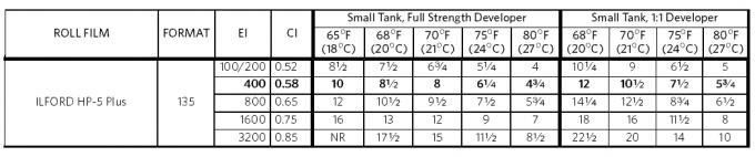

Chazzy is absolutely correct. Here is a curve from Foto Import which demonstrates what Xtol does with HP5... nearly linear response over a 14 f/stop range. HP5 is NOT by nature a gritty, harsh film... nor is Tri-X. You want NASTY, you must shoot in extreme contrast lighting.
BUT you can raise the contrast considerably. BELOW is the Kodak XTOL data. IF you've already tried the 3200 time (CI ,85 is VERY contrasty) then what you want is not CONTRAST, but a film response which DISTORTS the tonal relationship of your scene.
