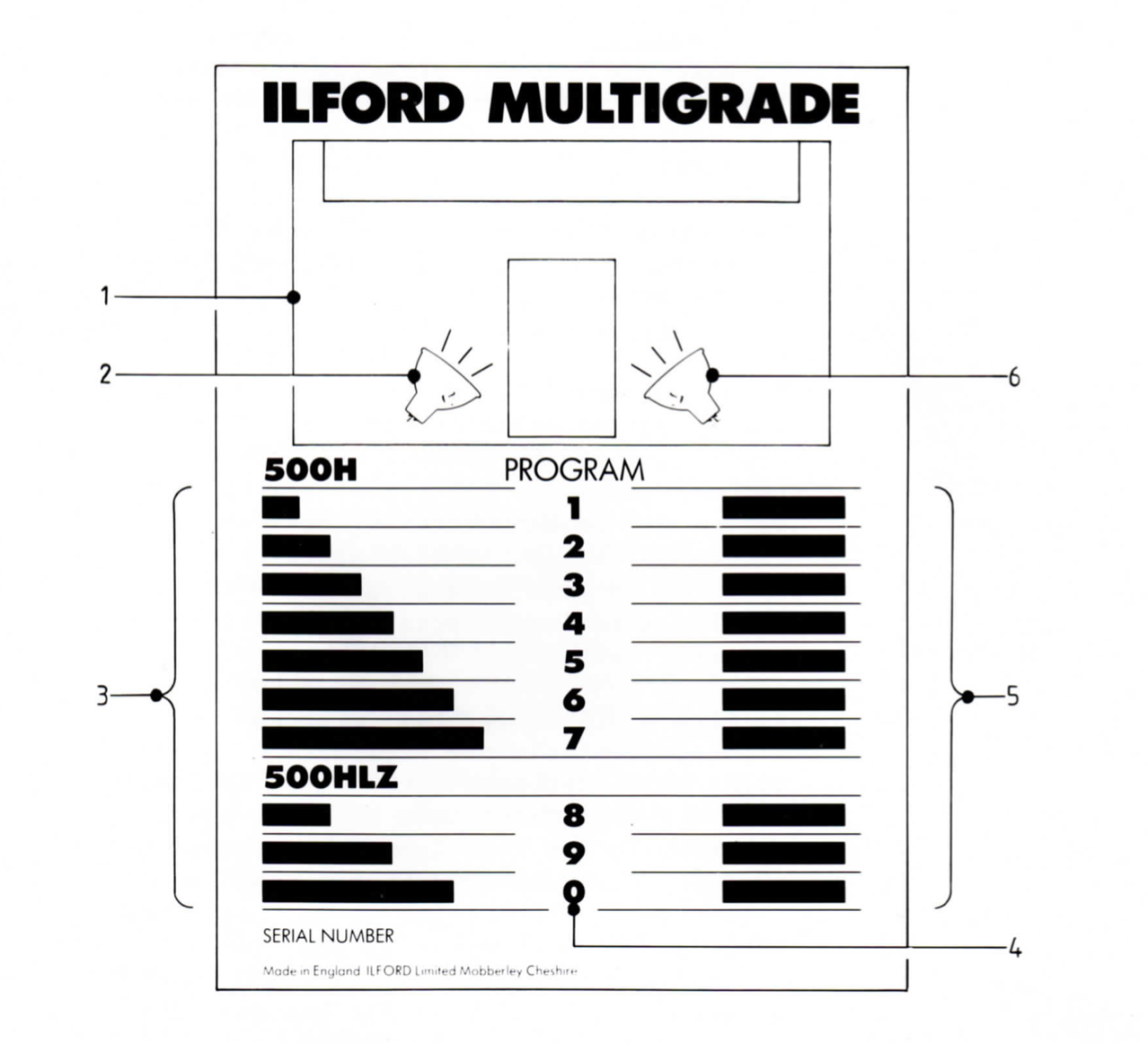

hello, help or tips for calibrating ilford head 500, use it to make split degree prints. the time unit has intensities for the green filter, what intensity do you recommend to use. whoever is using an ilford head, if you can share the configuration. gracias.

See section 3.7 in the manual. Normally it's set for balanced lamps - it's there to compensate for imbalances of output, can't say that was something that was really ever an issue with the ones I've worked with. It really only matters if you are doing things like running an HLZ head or an adapted MG400 head off the controller that supports the HLZ.

In Section 4.6 of the manual for the Ilford 500 head I had, one is asked to make a #5 print. Then then make multiple #0 prints with each of the seven 'calibration' settings. Then choose the 'calibration' setting where the mid tones of the two prints matched.
The seven 'calibration' settings alter the relative intensity of the green light (#2) only.

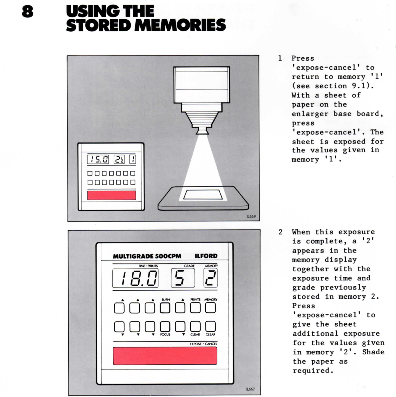

If you don't want to have both lights on at the same time and want to use two separate exposures for the grades, you could program memory #1 time for grade 5 and memory time #2 for grade 0.
If you are going to print this way, the calibration mentioned above is not needed.

Thank you for responding, yes you are correct, that the times are determined in choice of paper and grade. I was inquiring about the controls that have to the timer unit. below explain the manual.
Thank you, for the moment it was not a problem, only that having several intensities of configuration for the green filter, I had the concern of consulting... It is added that it is an equipment with its years, only the experience of the group can advise me.
Thank you, I don't know how to thank you for the advice you have shared.
Take into consideration what is mentioned in the manual, which is that I have version C and in the explanation it corresponds to the CPM. Anyway, I'll do the test with grade 5, which is all blue.
and with grade 0 considering the levels of multigrade C from 1 to 7
