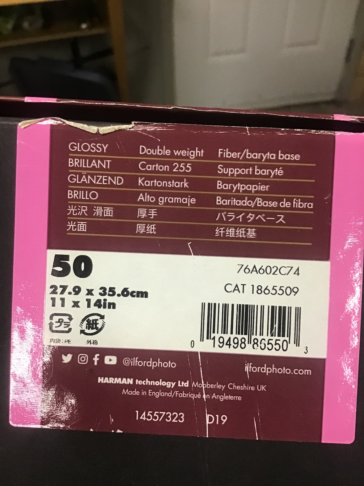

Here's the multilingual label on my box of Harman Glossy/Brilliant/etc.

Bolding and italicization added to highlight the spelling - and mis-spelling - that I missed in both cases.
