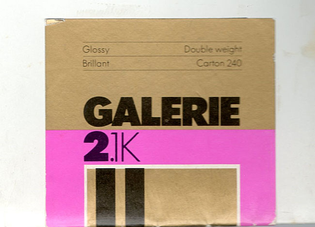

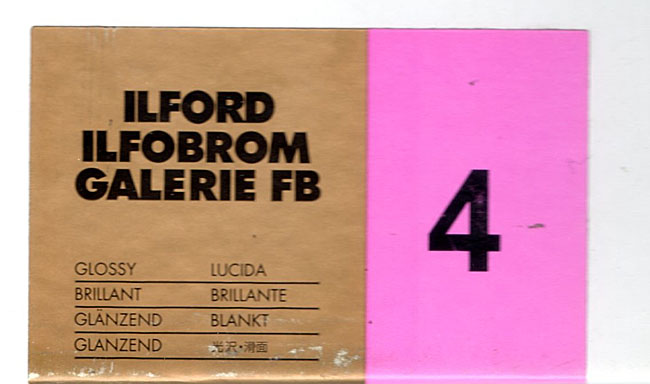

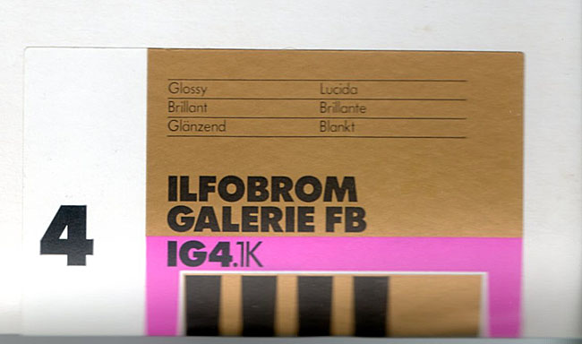

I sometimes buy some older Galerie. I have figured out the date code but was looking for a faster way to approximately date the paper from the label design.
The third picture shows what I believe is the current label as seen on on-line dealers sites. My only box with this label is from 2007. I'm wondering when this label started to be used? Also when was grade 1 and 4 dropped? Around 2008?
The second picture shows a label I believe started around 1994 and went till the current label started. Any idea on the dates this label was used?
The first label I believe is pre 1994 but I'm not sure when it started. I'm interested in it's date span but I avoid paper with this label unless it's really cheap. My own supply with this label still works for me but I know it's been kept frozen.
I think Galerie started around 1980. So it may have a lot of labels prior to these but they are all I can find in my supply. But I'll admit to using it in the 1980's.

Part of the story is that Galerie FB was introduced in 1990, with some changes from the original Galerie. So any paper with a label saying just "Galerie" is pretty old indeed.

That´s it. ... I started using Galerie myself awhile back and it´s a great paper. Drydown is almost nonexistent! From my knowledge Ilfobrom and Galerie were different papers first. Both were discontinued around 1990 and replaced by the new "Ilfobrom Galerie" that is still available today. Some people also claim the paper underwent some minor changes after that, while others report they can see no difference between new paper and Galerie from 20 years ago. Maybe Simon R Galley can respond to this?
