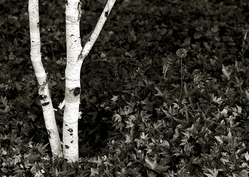

FP4 is a traditional film, and as Dennis states has slightly more grain than Acros which is a tabular grain type film.
I have found that Acros is comparable to TMax 100 in its grain and sharpness and to me has a colder more clinical feel than conventional emulsions.
I have a couple of tests if you want to look:
Fuji Acros
And
Ilford FP4
If you had to push me for my personal choice it's Acros for landscapes and FP4 for Portraits.

Acros is a very straight line film, so it will give good separation in the highlights, as Mark Antony's picture show. A film like FP4+ has a slight shoulder, which may compress the highlights, depending on exposure. The "metallic" or "clinical" look of Acros (a nice feature, I agree) is due in part to the modern grains and to the long straight line.

Mark Antony
Mar 27, 2007
789
East Anglia,
Tom yes there is more info on the negative; in fact a surprising amount of detail in the background, but I printed it down to make the dandelion stand out.
The rear of the picture is in shadow where the trunk and foreground are in diffused sunlight.
