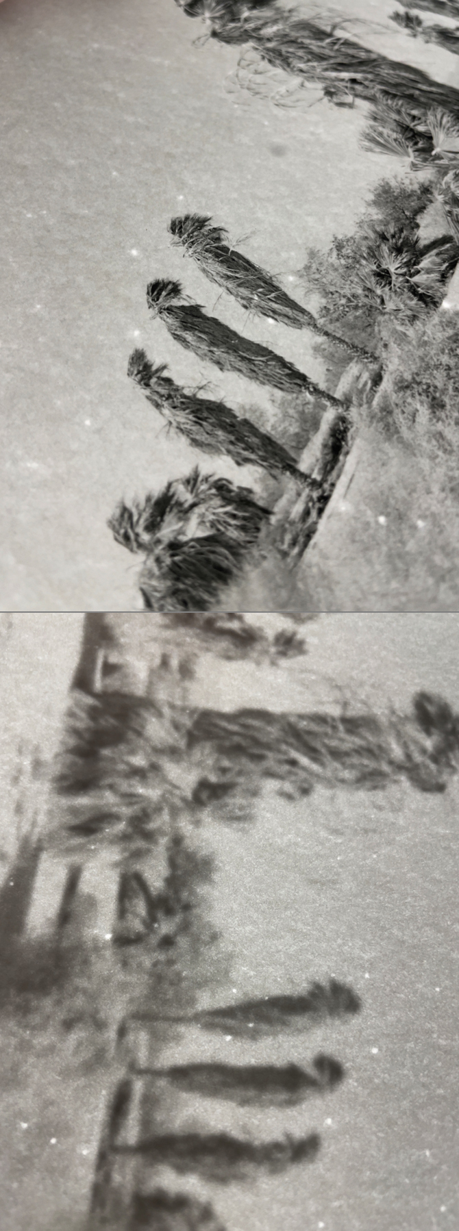

Hi, I actually ran into this same problem in July of 2021 and have been in touch with Sue Evans at Ilford about this. Unfortunately work has been overwhelming and I haven't had much luck getting back into the darkroom this fall and winter to troubleshoot further. I'd suggest reaching out to Sue and explaining the problem. Use the contact form on the Ilford website and ask for Sue Evans regarding defects on Ilford FB paper.
Essentially what I gathered was the base had some inconsistencies which cause spots that look dark when front lit, but if you back light you will see them as bright dots. They were able to replicate it in their lab with a certain batch of paper of which mine was part of. They sent me a fresh box of paper from a new batch to replace/test with, but I haven't had a chance to set up the darkroom.
For reference I was using Ilford Warmtone FB paper. Attached is an example of the defect, held up to a light backlighting the paper and photographed via iPhone.
For reference I was using Ilford Warmtone FB paper. Attached is an example of the defect, held up to a light backlighting the paper and photographed via iPhone. View attachment 302103
Thanks for the info. I’ve had these little spots also.
