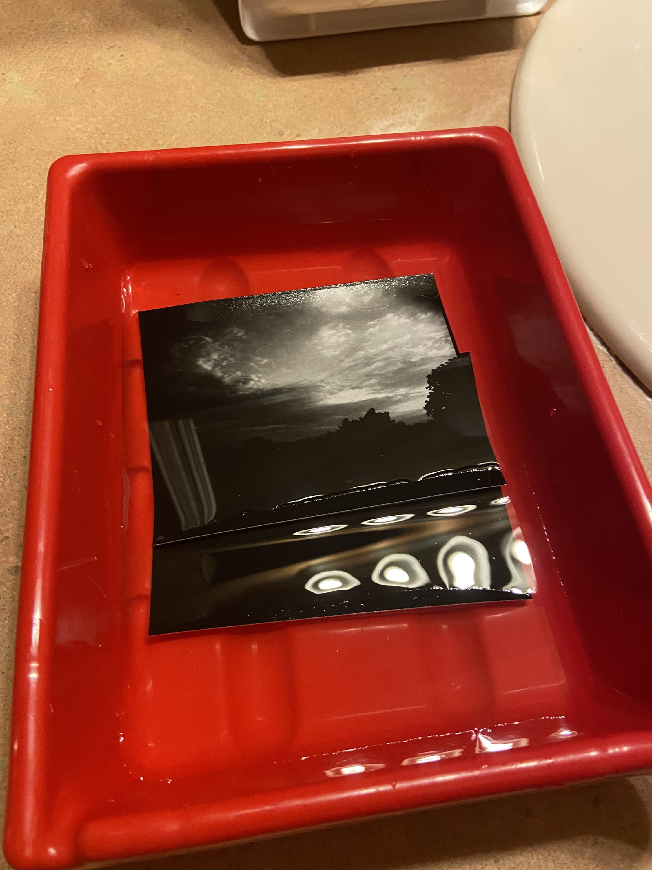

I'm getting ready to chuck the pack in the trash ... I'm struggling to get an image with the Ilford 4x5 Direct Positive paper. I'm shooting it in my 4x5 camera.
Last night, using my light meter I got an image (over exposed, but there was something there). Today, I went back out at an earlier time of day and shot in the shade. My meter was telling me ISO 3, f/11, at 1/2 second. But my thought was with all black prints coming out, to reduce the light so I compensated by shooting at ISO 3, 1/125 and f/32
I also adjusted the development times according to the Ilford spec sheet (1:30 development, 30 second stop, 1:30 fix). Images today are all black. I wasn't expecting perfect exposures, but I was expecting an image of some kind.
I'm tired of wasting sheets - any advice? I'm at the point of frustration where I'm not longer thinking critically with this product any longer.
The only new thought I have is possibly the temp of the developer? I'm in an A/C room that's set to 75, so even with the heat outside I didn't think that could be the issue?
Thanks!

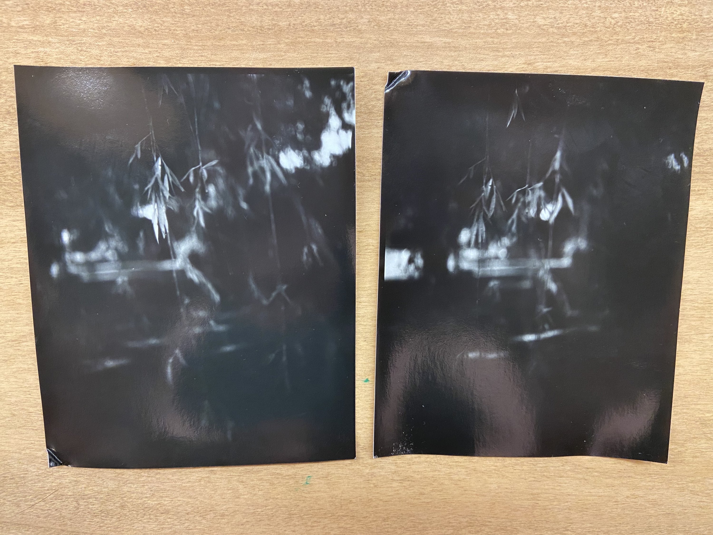

Here you go! These were the first two that I felt like I finally was understanding what everyone had shared ... still refining and improving. But yea! No blank black rectangles! Thanks again for everyone's help.

That's a good start! And an example of the high contrast of that material.
Preflash would help fill in the details in the shadow areas (which is how it both boost effective speed and reduces contrast a little), but selecting a subject with lower brightness ratio (or one where you can control the light for that purpose) would do about as well. The rule for shooting positives is "meter for the highlights" -- and then you have to hope the shadows cooperate.
