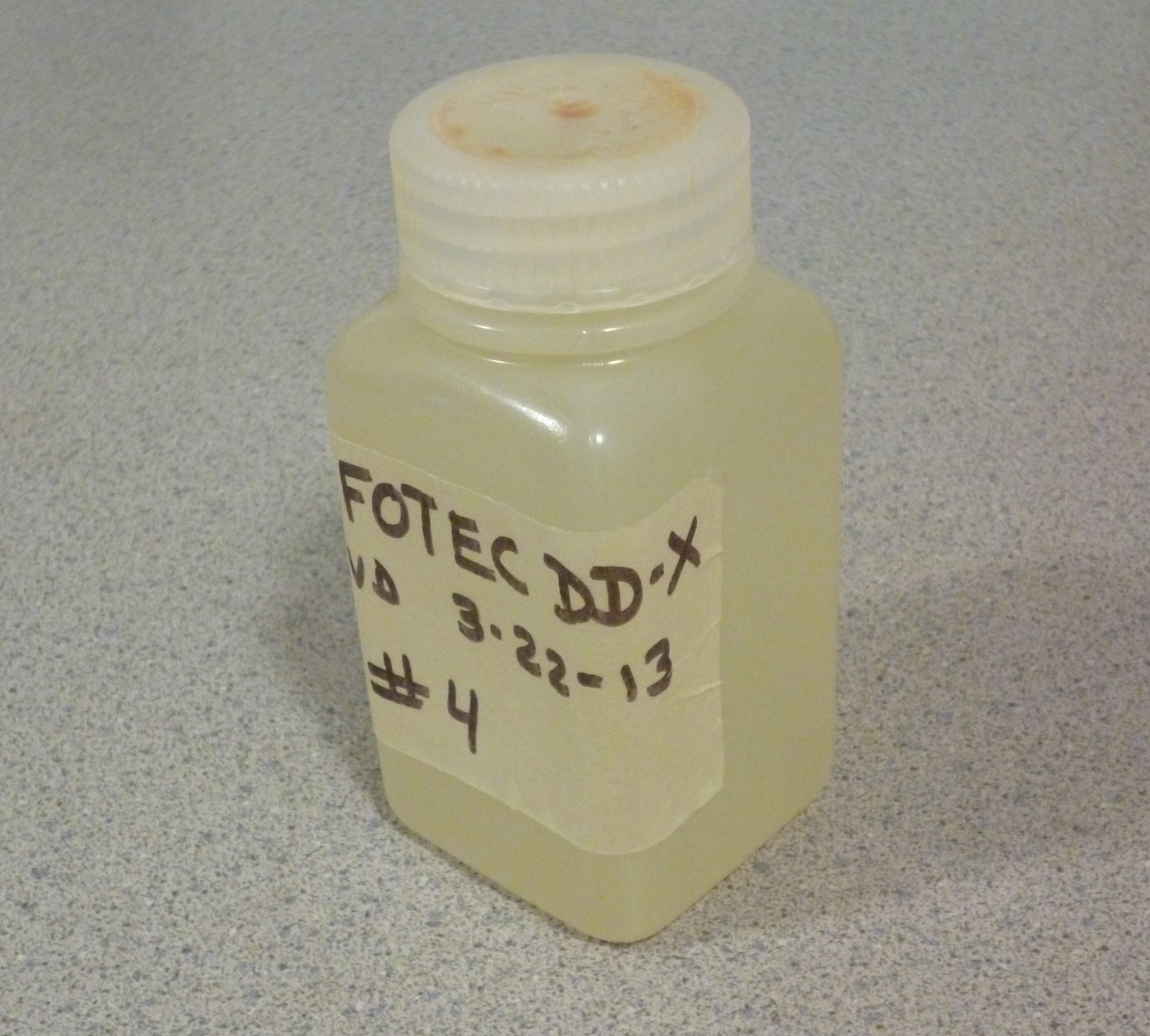

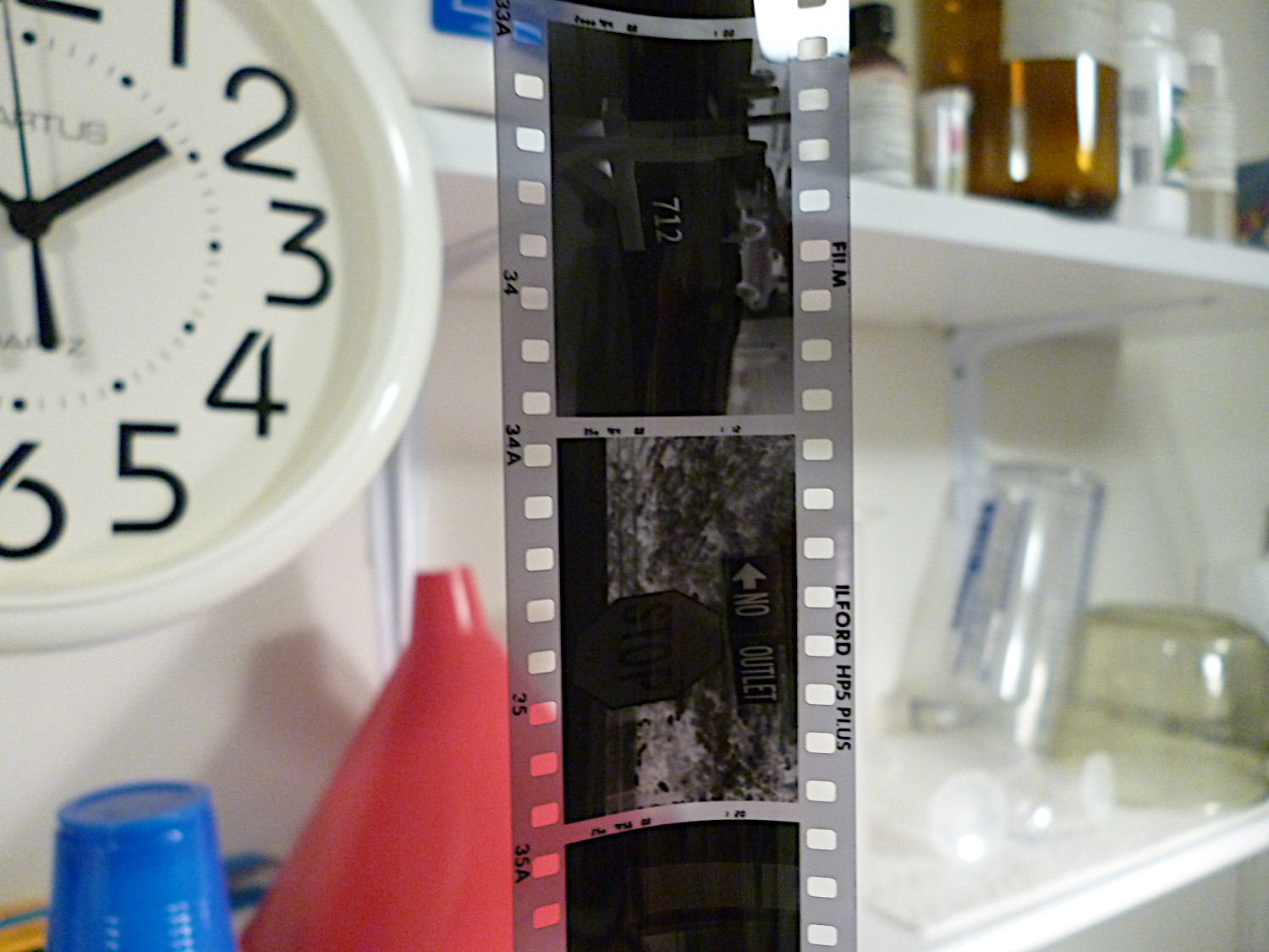

Just to add another data point to this very old thread, I just developed a roll of HP5+ in DD-X developer purchased in March 2013. Since the fiasco with Kodak chemicals began, I have been experimenting with various non-Kodak developers. For me, shelf life is an important factor, so I have been thinking about switching to Ilfotec DD-X and/or HC some of which I just happen to have on hand from an order in 2013. I think HC is well known to have a long shelf life, but DD-X is specified to have a shelf life of 24 months. Today I tested the DD-X with HP5. Unfortunately, I over developed the film. At the elevated temperature using my typical agitation, 6-7 minutes would have been closer to what I prefer in the way of contrast/density.
Film:
Short roll (12 exposures) of unexpired HP5+ shot at EI 400 with Nikon F6 and 24-120 mm f4.0 lens.
Development:
Ilfotec DD-X diluted 1+4 with distilled water at 72F for 8 minutes. Developer was decanted into smaller bottles when opened in 2013.
Patterson 2-reel tank using one reel along with spacer.
Constant inversion agitation for 30 sec followed by 5 inversions every 30 sec.
The film is still drying so I just took a snapshot so you can see the density. Of course, a 12 exp roll does not guaranty equal performance with a 36 exp roll.

I am very pleased. I've read forum posts that suggested that DD-X as well as TMax developers use glycol as a solvent, so I expect them to have a fairly long shelf life, but 8.5 years was way more than I was expecting. I'm pretty sure even I could go through a liter of DD-X in less than 8 years. LOL! I also have some HC that's just as old, so I will test that soon, but I expect it will most likely be good as well since it is certainly glycol based. I don't have much faith in the "new formula" Kodak-branded developers and I probably won't live long enough to wait years for them to reestablish a history of reliability assuming they ever do.
